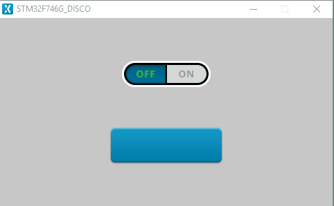

Hello thank you!
I have a "ButtonOffOn" toggle button. I have a "ButtonNext" button that changes the screen. I want the button "ButtonNext" to be locked while the "ButtonOffOn" button is switched on until the "ButtonOffOn" button is switched again.
I checked your suggestion but disables the "ButtonOffOn" button.
"ButtonOffOn" = On -> "ButtonNext" closed
"ButtonOffOn" = Off -> "ButtonNext" is active
How to do it?

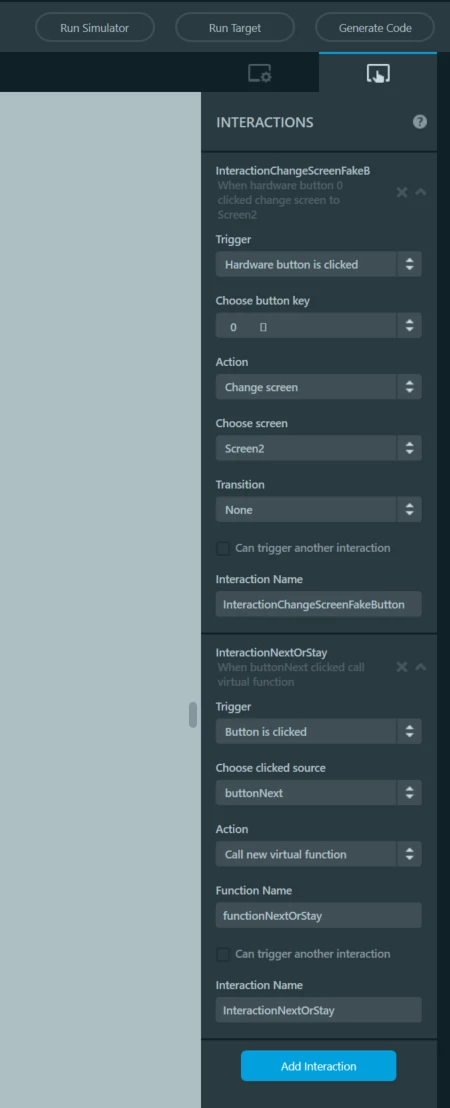

Romain DIELEMAN
Feb 21, 2020 3:19 PM UTC
I suppose you could do something like this: in Designer you create 2 interactions. The first one calls a new function when the button "ButtonNext" is clicked. The other interaction changes the screen when an hardware button is clicked. This is a fake button we use in order to generate the go to screen 2 transition function and use it in our code.0690X00000DC603QAD.png
Then I added this in Screen1View.cpp
void Screen1View::functionNextOrStay()
 if (ButtonOnOff.getState() == TRUE) // getState returns TRUE when On
 application().gotoScreen2ScreenNoTransition();
Tell me if this enough for what you need, I did not need to use setTouchable() since it does not influence the result.
/Romain
