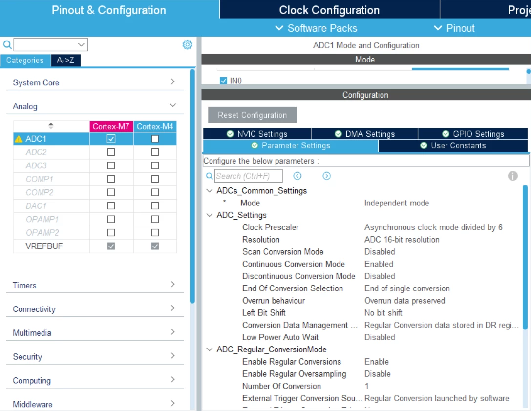

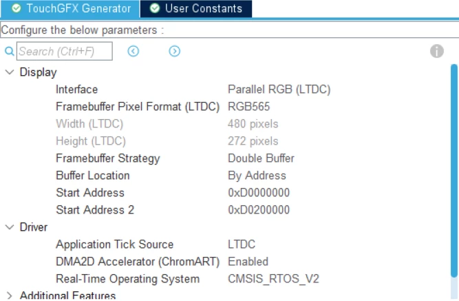

  • If somebody find the solution for this issue ? Can you share your solution please ?
I am using :
  • CubeMx version 6.7
  • Cube IDE version 1.11.2
  • TouchGFX designer 4.21.3
  • STM32H745 DISC0 board
My first project without ADC was working well. I was able to display animation on the HMI. But since I added the ADC, the screen is blank. After debug, I can see the tasks are running well, even the TouchGFX task also is running. But the display is blank.
I checked the pins and the pin PA0_C of my ADC is not in conflict. So I guess that the issue is coming from another side ?
