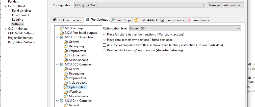

Hi to all, i want to try a TouchGFX i create a simple example, i use CubeMX and select X-Cube-TouchGFX 4.13.0 for additional software, i configure all well, i see example and webinar for configure it and use TouchGFX designer for insert a simple UI for my example, all work well.
I generate a IAR project with CubeIDE, i use Application structure : Advanced and
linker Settings : Heap = 200 ; Stack = 800;
now If i compile the project i don't have problem but if i Make the project i see this error:
Error[Lp011]: section placement failed
 unable to allocate space for sections/blocks with a total estimated minimum size of 0x17'd129 bytes (max align 0x4) in <[0x800'0000-0x80f'ffff]> (total uncommitted space 0xf'fe38).
later i generate the project for STM32CubeIDE and i try whit it, but i see this error:
c:\st\stm32cubeide_1.2.0\stm32cubeide\plugins\com.st.stm32cube.ide.mcu.externaltools.gnu-tools-for-stm32.7-2018-q2-update.win32_1.0.0.201904181610\tools\arm-none-eabi\bin\ld.exe: region `FLASH' overflowed by 596908 bytes
collect2.exe: error: ld returned 1 exit status
make: *** [makefile:74: TEST_1.elf] Error 1
"make -j8 all" terminated with exit code 2. Build might be incomplete.
can you help me?
best regards and excuse me for my bad english
Antonio

Cartu38 OpenDev
Graduate II
Feb 14, 2020 1:21 PM UTC
Have you got a chance to play with compilation optimization capabilities ?. Maybe your final binary sized may be shrunk a bit helping you to fit your current hardware resources. Let's play with project settings and C/C++ build settings if STM32CubeIDE.
antonioB
antonioBAuthor
Feb 17, 2020 9:03 AM UTC
hi thanks for your answer, i have default optimization, Optimization Level -O0 , as you can see for immage that i attach
