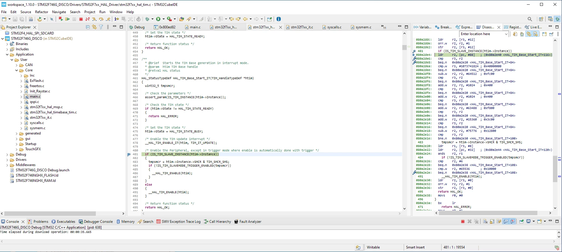

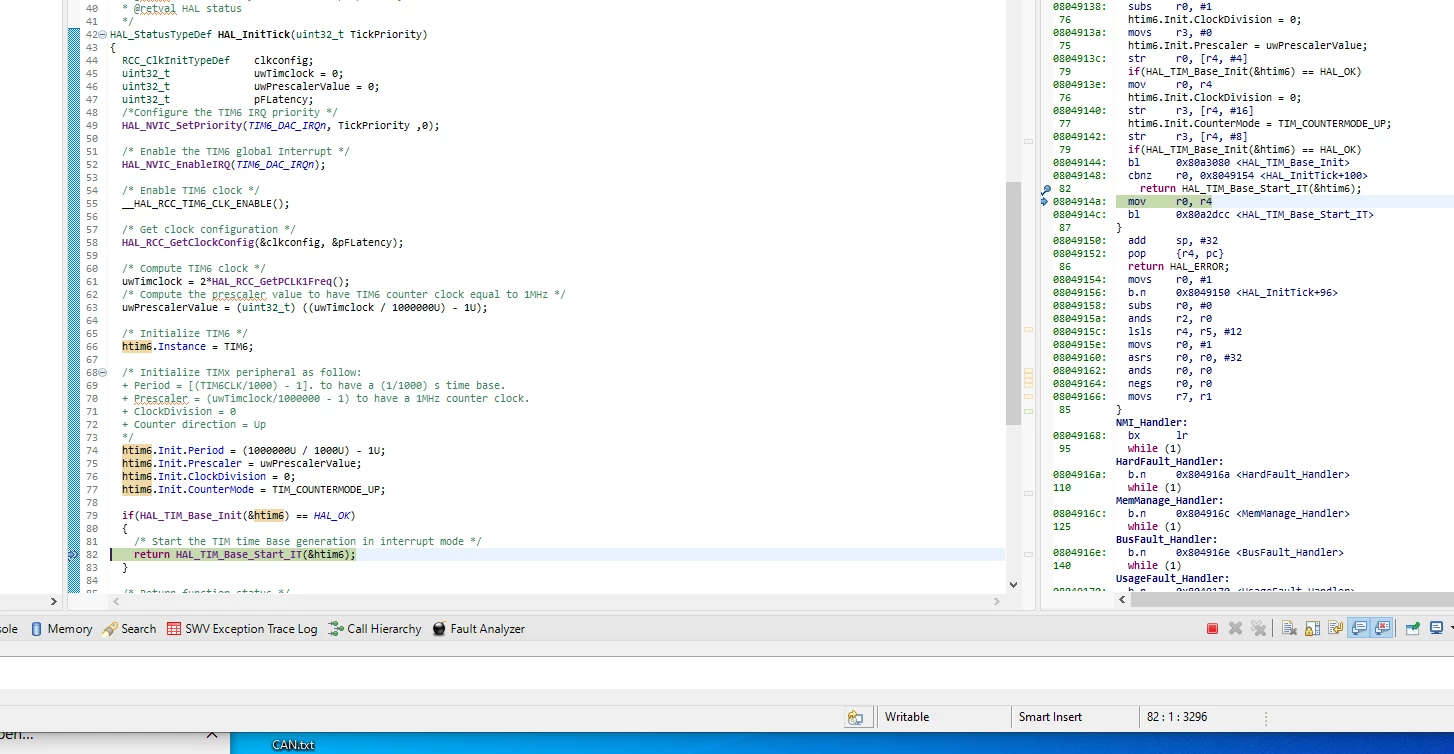

 In debug mode the uC runs up to a certain point (until Breakpoint - picture below). Then the uC disappears somewhere. But no HardDefault Handler is called, otherwise there is an error.

The problem arises in the HAL_InitTick() function when Timer6 is started.

Hello again @PHolz.1 ,
Sorry for the delay, So in this case the problem arises from the fact that you are initializing the peripherals twice. I suggest initializing it once or at least using HAL_TIM_Base_DeInit() first before initializing the timer again.

Apr 26, 2024 12:44 PM UTC
Hello, thanks for the suggestion. It fixed my error.
