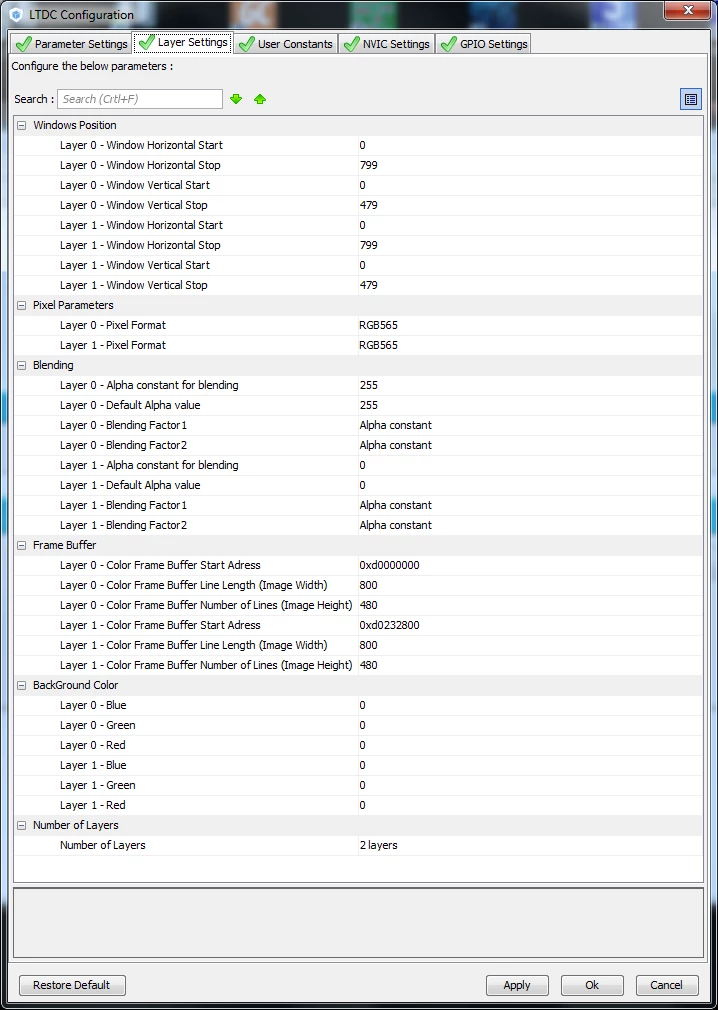

the config of LTDC and Layers, we are discussing TFT display problems. I attached my layer settings for 800x480.

for blending, did you try ARGB8888 for the layer settings ? It does not need to match to the TFT output settings.
