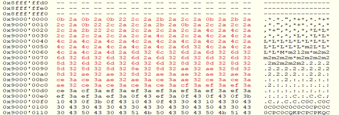

Memory window in the IAR
Part of the array where it is stored backgrounds image

Oct 17, 2024 8:38 AM UTC
File would be the .ELF and the section within the object file describing the 0x90000000 address space.
The memory dump from the debugger, via memory mapping looks ok.
The external loader from IAR seems to be having less success reading the content it just wrote.

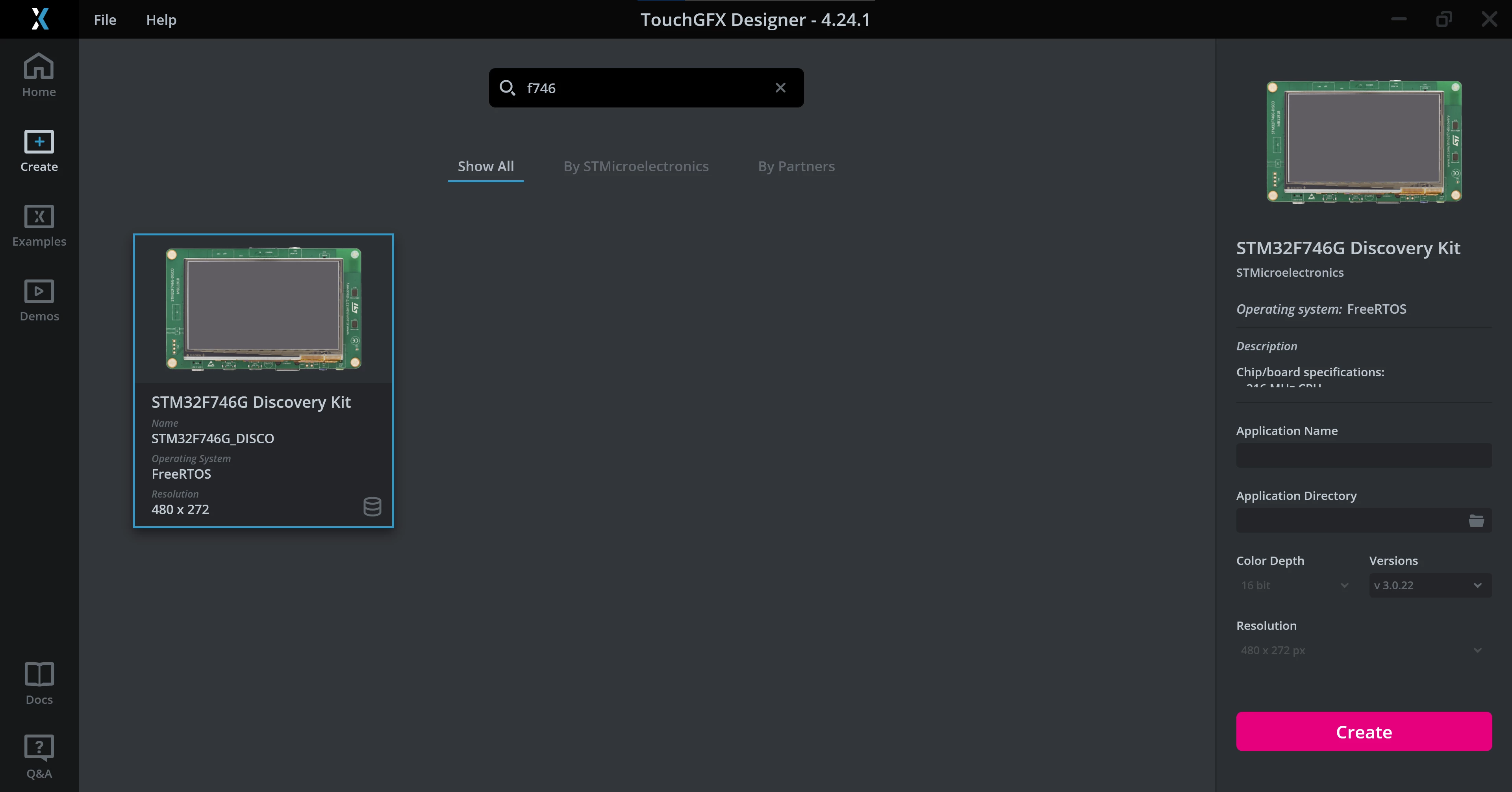

Oct 17, 2024 10:34 AM UTC
Hello @Alex_777,
TouchGFX supports IAR Embedded Workbench, and if you use the provided TouchGFX Board Setup (TBS) for the STM32F746G Discovery Kit, then you can open the STM32CubeMX project (.ioc file), and change the Toolchain/IDE from the "Project Manager" tab to EWARM, and press generate code. Then, from your TouchGFX project, you have generate code as well. By navigating to the EWRAM folder in your project's directory, you can access the IAR project. The required settings are already provided; therefore, you don't need to change anything.
TBS for STM32F746G Discovery KitTBS for STM32F746G Discovery Kit
EWARM directoryEWARM directory
If you still have trouble downloading the program to your board, you can compile the program by IAR, and use the outputted .hex file to download on your board with STM32CubeProgrammer. You can read more about this process here.
I hope this helps you!

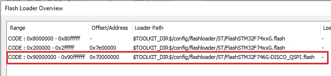

Oct 17, 2024 12:19 PM UTC
>  mb1191-F746NGH6-C01
Is this board the STM32F746G_DISCO? External flash loaders should match the board (actually, pinout of QSPI controller and the flash chip).
The .board files of IAR EWARM are text files that list the used "external loaders" and their parameters. A board can have several external memories and several loaders.
> I did't find the .elf file in the iar directory with my project.
IAR creates tweaked .elf files with extensions "out" and "sim" (simplified?).
Alex_777Author
Oct 17, 2024 12:40 PM UTC
Yes, I have STM32F746G DISCO. I understand that the external flash loaders should match the board.
In the IAR I use the file FlashSTM32F746G-DISCO_QSPI.flash
Below is the content of this file:
<?xml version="1.0" encoding="iso-8859-1"?>
<flash_device>
<exe>$TOOLKIT_DIR$/config/flashloader/ST/FlashSTM32F7xx_QSPI_MICRON.out</exe>
<page>256</page>
<block>256 0x10000</block>
<flash_base>0x00000000</flash_base>
<macro>$TOOLKIT_DIR$/config/flashloader/ST/FlashSTM32F746G-DISCO_QSPI.mac</macro>
<aggregate>1</aggregate>
</flash_device>
Do I understand correctly that QSPI_MICRON is the MT25QL128?
How can one be sure of this?

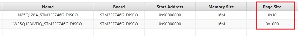

Oct 17, 2024 12:02 PM UTC
As for the program STM32CubeProgrammer, it does not support the memory MT25QL128, you need to create the .stldr file manually.
Memory chips N25Q128A and W25Q128J has the same page size - 256 bytes.
Why do we see different page sizes in STM32CubeProgrammer?
Tesla DeLorean
Tesla DeLoreanBest answer
Guru
Oct 17, 2024 12:26 PM UTC
The N25Q128 is just a much earlier variant of the Micron part, perhaps with an older die, when ST/Micron were fab partners. I'd imagine the newer parts have shrunk die to increase wafer yield as part of Micron's longevity model, which is form-fit-function not making the same die for decades, allowing them to pivot into new tighter geometries as fab tech advances.
Similarly the page size of both the Micron and Winbond are 256 bytes. The loader does the deblocking internal when given a large buffer. Cube Programmer uses this value as a guide to how to align Write() requests on a address and size basis.
The Winbond and Micron have slightly different architecture, and management of status registers and mode.
