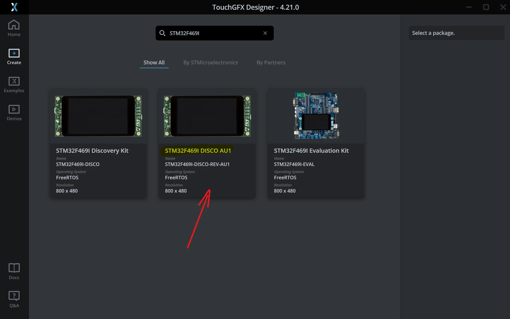

Romain DIELEMAN
November 14, 2022
Could you share your board revision ? You should be able to find this on a white sticker on your board. The displays or touch controllers are sometimes changed between revisions of the board which might explain your issue.

@Osman SOYKURT​ Any update / workaround for this issue (ticket n°138075)?
Osman SOYKURT
November 29, 2022
Hello JJaco.7,
Did you try @Romain DIELEMAN​ 's solution on this thread? We're waiting for the delivery of this board revision, couldn't test it here yet.
/Osman
EmbDev
Senior
November 29, 2022
Got it up and running with TouchGFX in the meantime.
The LCD_Reset pin should indeed be set to PP instead of OD.
If anyone is interested, please let me know. Do not have an example application right now, just my actual project which I cannot share.

Osman SOYKURT
January 9, 2023
Hello LDini.1,
A new TBS is now available on TouchGFX Designer 4.21.0 for this STM32F469I-Disco $AU1 revision (B08)
It should resolve the issue with the black screen.
