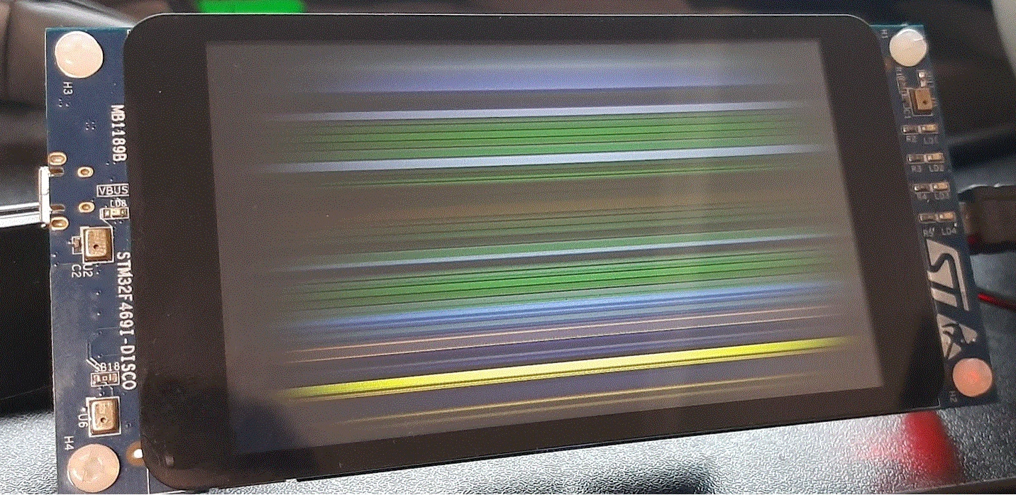

And here example what I can see on the LCD

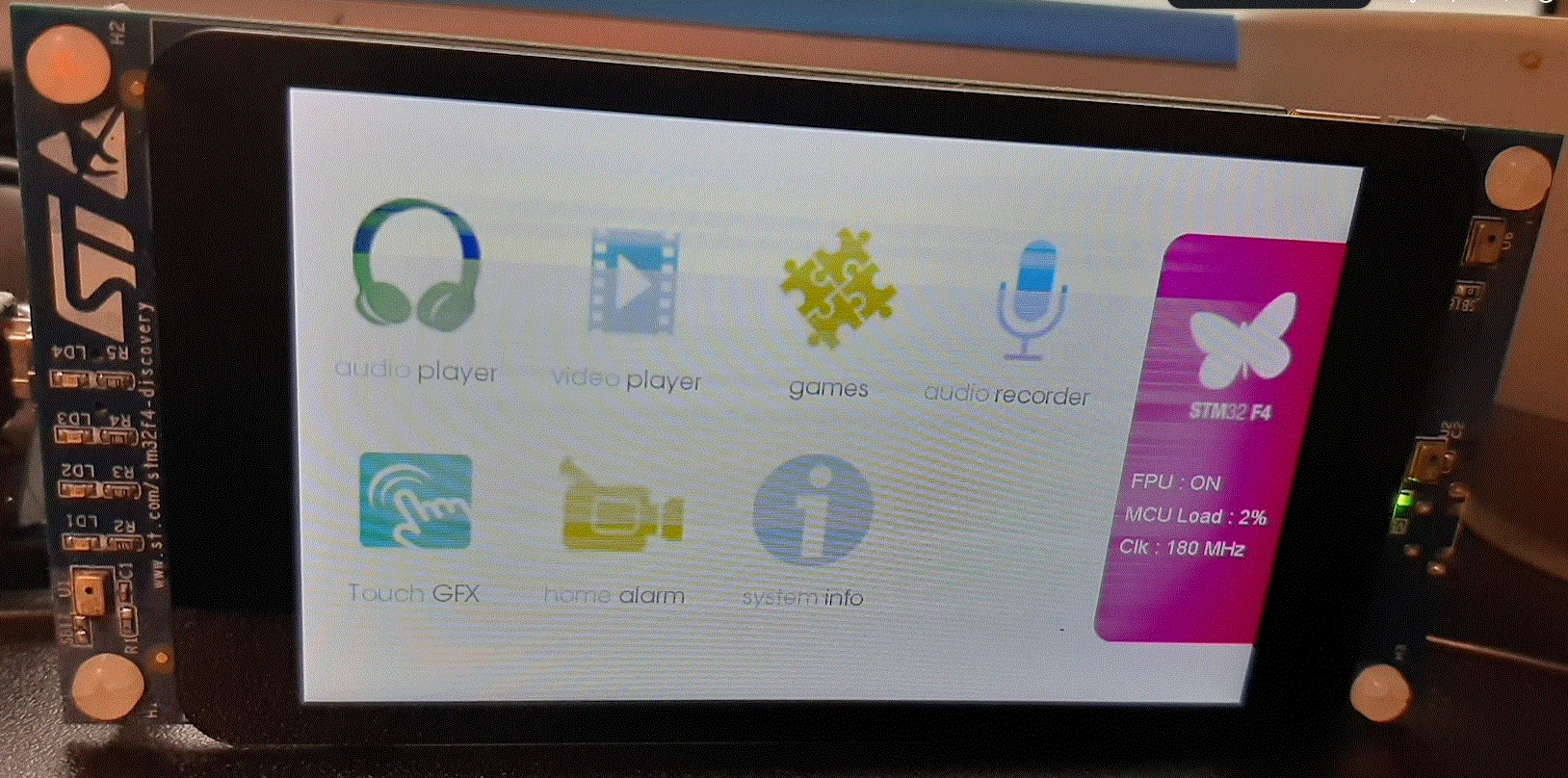

0693W00000KZxqLQAT.pngThen I'm taking compiled demo binaries from official page and program it using STM32CubeProgrammer

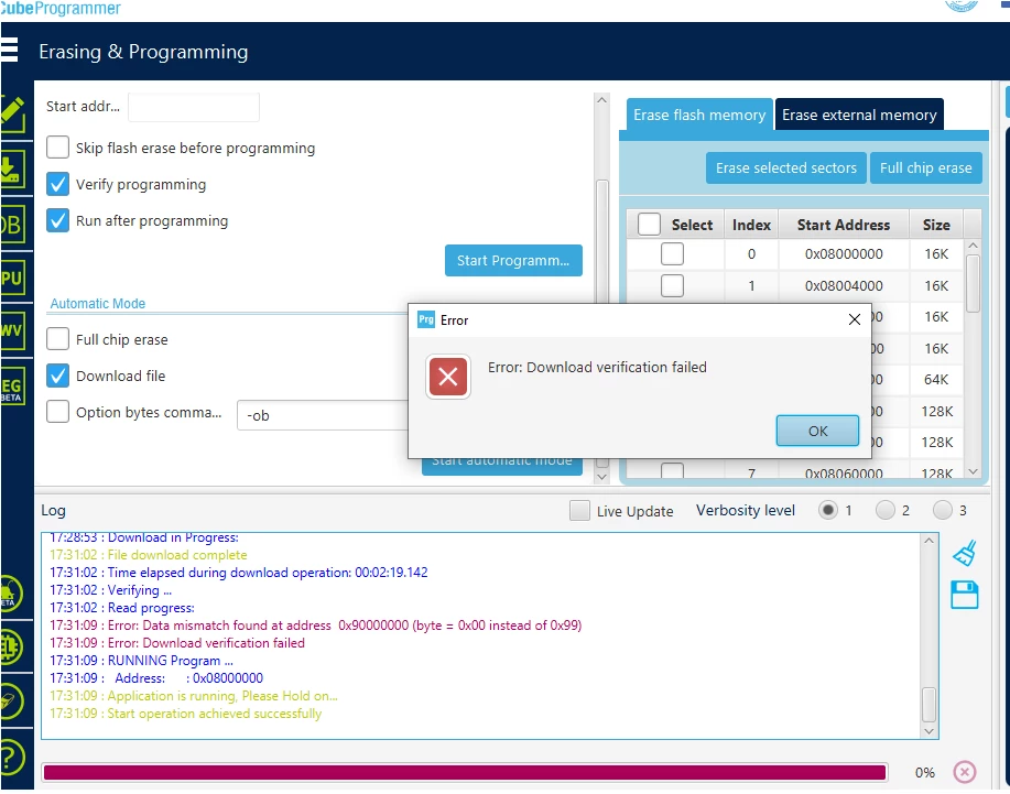

0693W00000KZxrdQAD.pngIf I leave board without power for some time, 10 - 15 mins, this white lines gone and image became good. But this not work with examples - they didn't work after board "rest".
Also tried to program binaries compiled by STM32CubeIDE with STM32CubeProgrammer - the same but with some verification errors.
And official demo binaries also says verification errors.
0693W00000KZxtPQAT.pngIs it some hardware issue on my board and I need new one?

Your board equip too external QSPI memory and you need manage it.
Error on image is about it.

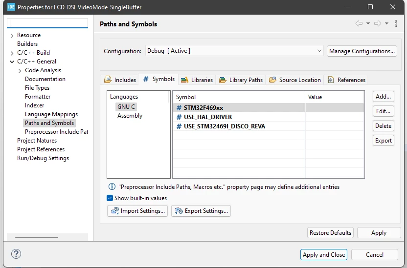

Change project settings: [c/c++]>[patch and symbols]>[symbols]
delete USE_STM32469I_DISCO_REVC
add USE_STM32469I_DISCO_REVA
DMusz.2
Visitor II
March 3, 2022
0693W00000KbLEmQAN.pnglike this :)

Depending on the version of the board:
USE_STM32469I_DISCO_REVA (25Mhz external osc)
USE_STM32469I_DISCO_REVB (8Mhz external osc)
USE_STM32469I_DISCO_REVC (NT35510 lcd driver)
