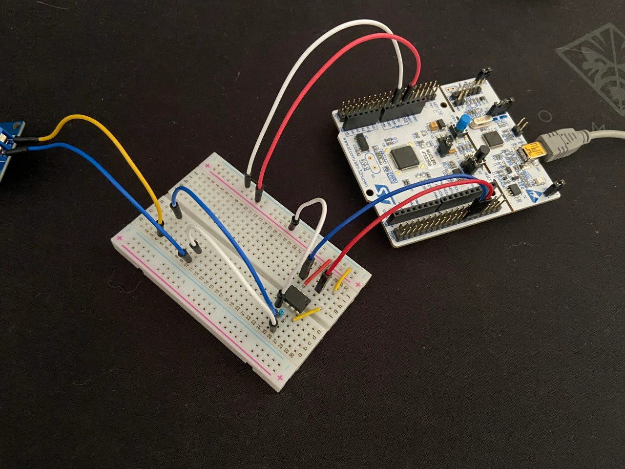

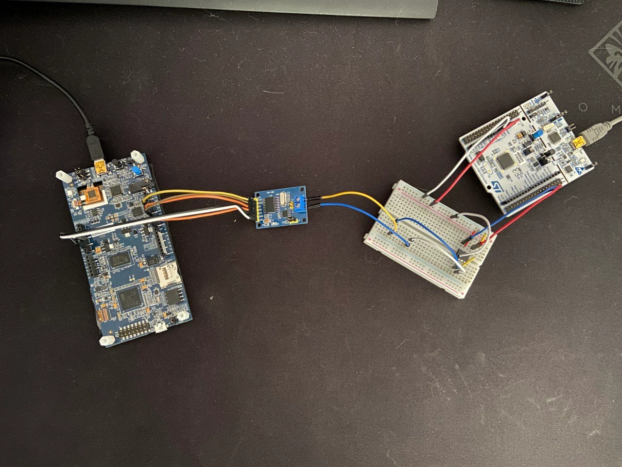

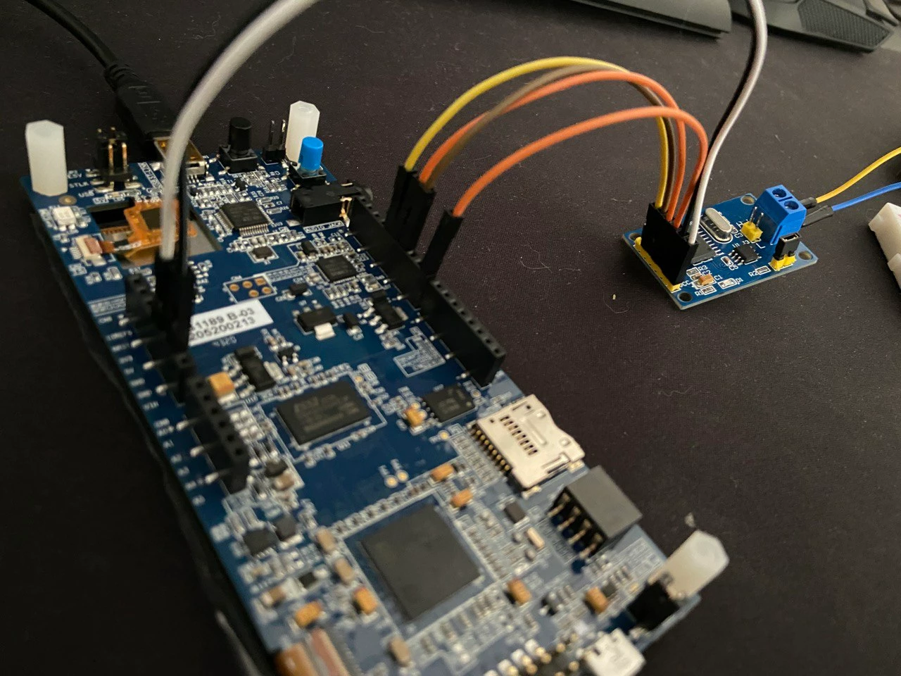

Hello everyone, I’m still inexperienced and I have to use the CAN with the F469I screen, but I was unable to operate the built-in CAN1 and CAN2 (honestly, I still don’t understand why CAN2 doesn’t work.). So I decided to use a CAN shield (SPI-CAN) but I can’t figure out what I’m doing wrong.
In particular, I use this library : https://github.com/eziya/STM32_SPI_MCP2515

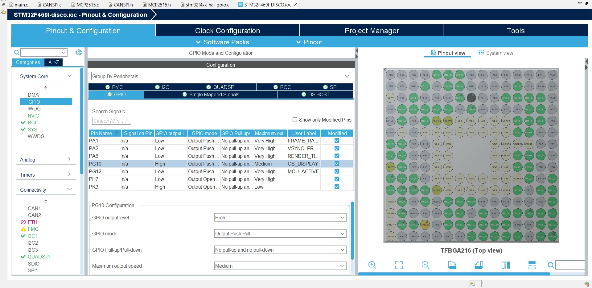

 MX_GPIO_Init();
 MX_CRC_Init();
 MX_DMA2D_Init();
 MX_DSIHOST_DSI_Init();
 MX_FMC_Init();
 MX_LTDC_Init();
 MX_QUADSPI_Init();
 MX_I2C1_Init();
 MX_SPI2_Init();

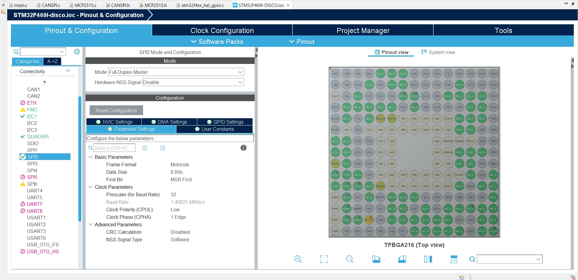

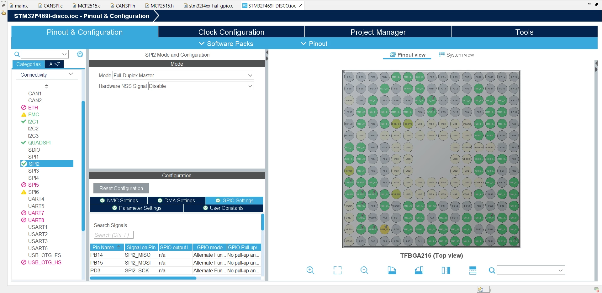

 hspi2.Instance = SPI2;
 hspi2.Init.Mode = SPI_MODE_MASTER;
 hspi2.Init.Direction = SPI_DIRECTION_2LINES;
 hspi2.Init.DataSize = SPI_DATASIZE_8BIT;
 hspi2.Init.CLKPolarity = SPI_POLARITY_LOW;
 hspi2.Init.CLKPhase = SPI_PHASE_1EDGE;
 hspi2.Init.NSS = SPI_NSS_SOFT;
 hspi2.Init.BaudRatePrescaler = SPI_BAUDRATEPRESCALER_32;
 hspi2.Init.FirstBit = SPI_FIRSTBIT_MSB;
 hspi2.Init.TIMode = SPI_TIMODE_DISABLE;
 hspi2.Init.CRCCalculation = SPI_CRCCALCULATION_DISABLE;
 hspi2.Init.CRCPolynomial = 10;

Together with the display, I use an F302R8 as the second CAN node. This node is sure that it works and that it is configured well (already tested) but if you need poss or post the code.
I tried with many combinations, even changing SPI of the F469 or jumpers but it doesn’t work anyway.
Could it be Baudrate’s problem? I am now using a 1Mbit/s baudrate, I used datasheet formulas (MCP2515) whereas the CAN shield is 8Mhz.

Here also the hardware connections & STM ioc configuration : 0693W00000Nt82qQAB.jpg0693W00000Nt80pQAB.jpg0693W00000Nt7zJQAR.jpg0693W00000Nt82WQAR.png0693W00000Nt82HQAR.png0693W00000Nt827QAB.png
