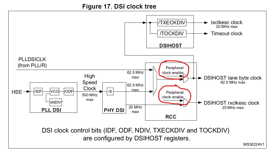

I suspect the reason I'm not getting DSI clocks is because the RCC Peripheral Clock enable is not being enabled.

Unfortunately the API for STM32F4xx does not define the parameter RCC_PERIPHCLK_DSI or the  member selection of PeriphClkInit.DsiClockSelection I believe these are from the STM32L4xx API (though the documentation doesn't explain this nor state that the configuration is explicitly for the STM32L4xx or at least not for the STM32F4xx which is in my opinion a bit poor!).

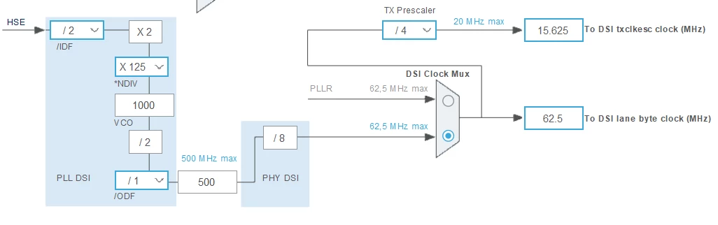

I may be barking up the wrong tree here as my .ioc configuration for STM32CubeMX definetly shows the DSI clock source as coming from DSIPHY, however I don't see a way to enable the DSI Host clock from the RCC either in STM32CubeMX or in the code.

DSI clock source is either the DSI PHY or PLL R tap, selected via RCC_DCK_CFGR / DSISEL, default is from the PHY
RCC_APB2ENR for the DSIEN and LTDCEN
Mechanics of bring up fairly well demonstrated here:   https://github.com/STMicroelectronics/32f469idiscovery-bsp/blob/ec051de2bff3e1b73a9ccd49c9b85abf7320add9/stm32469i_discovery_lcd.c#L178

I use F469 and never require this. But i search and found in drivers rcc headers FYI
#if defined(STM32F469xx) || defined(STM32F479xx)
#define __HAL_RCC_DSI_CLK_ENABLE() do { \
 __IO uint32_t tmpreg = 0x00U; \
 SET_BIT(RCC->APB2ENR, RCC_APB2ENR_DSIEN);\
 /* Delay after an RCC peripheral clock enabling */ \
 tmpreg = READ_BIT(RCC->APB2ENR, RCC_APB2ENR_DSIEN);\
 UNUSED(tmpreg); \
 } while(0U)
#define __HAL_RCC_DSI_CLK_DISABLE() (RCC->APB2ENR &= ~(RCC_APB2ENR_DSIEN))
#endif
/** @brief Macro to configure the DSI clock.
 * @PAram __SOURCE__ specifies the DSI clock source.
 * This parameter can be one of the following values:
 * @arg RCC_DSICLKSOURCE_PLLR: PLLR output used as DSI clock.
 * @arg RCC_DSICLKSOURCE_DSIPHY: DSI-PHY output used as DSI clock.
#define __HAL_RCC_DSI_CONFIG(__SOURCE__) (MODIFY_REG(RCC->DCKCFGR, RCC_DCKCFGR_DSISEL, (uint32_t)(__SOURCE__)))
/** @brief Macro to Get the DSI clock.
 * @retval The clock source can be one of the following values:
#define __HAL_RCC_GET_DSI_SOURCE() (READ_BIT(RCC->DCKCFGR, RCC_DCKCFGR_DSISEL))
/** @defgroup RCCEx_DSI_Clock_Source RCC DSI Clock Source
#define RCC_DSICLKSOURCE_DSIPHY 0x00000000U
#define RCC_DSICLKSOURCE_PLLR ((uint32_t)RCC_DCKCFGR_DSISEL)

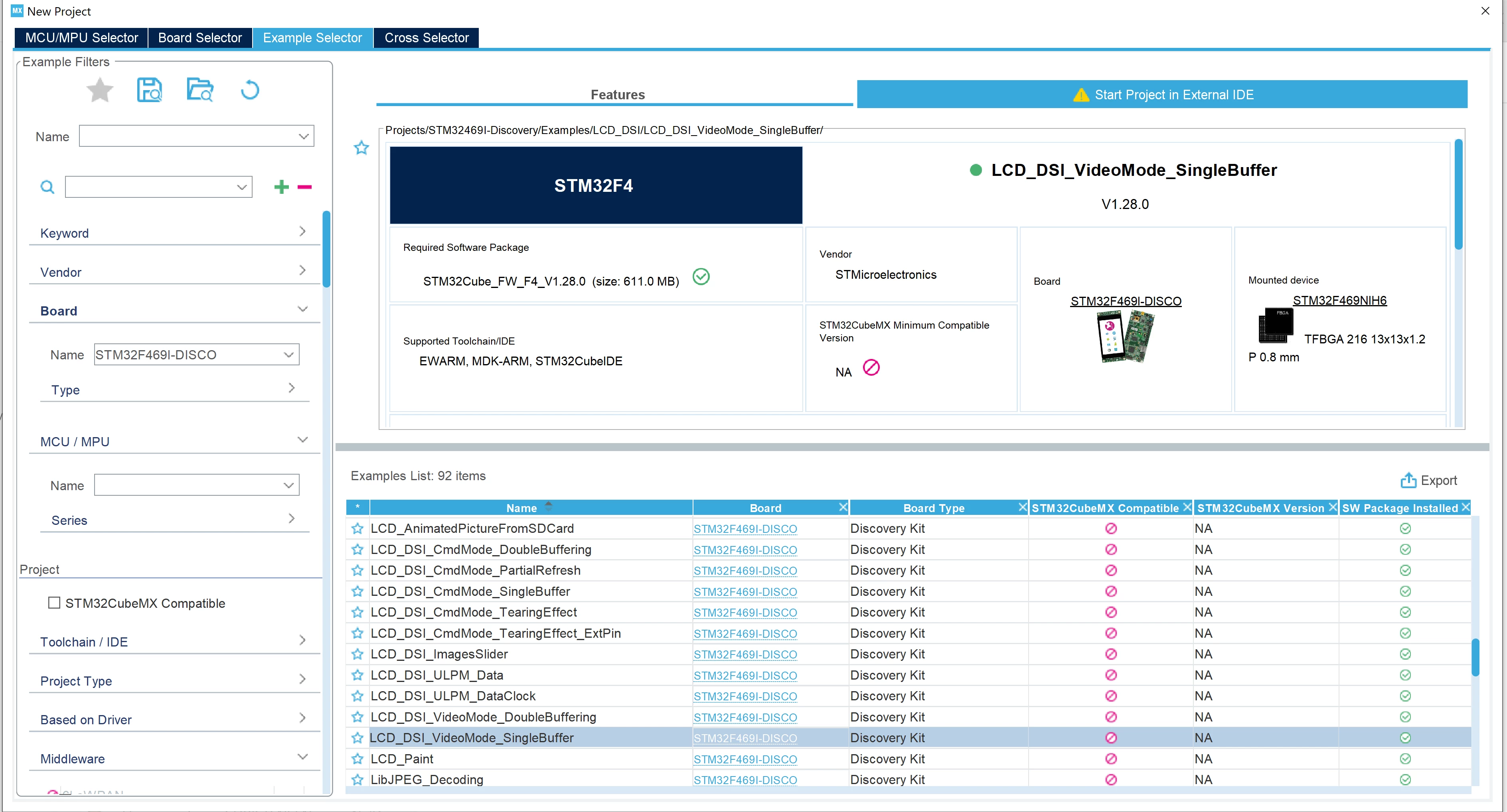

May 2, 2024 1:06 PM UTC
Hello @RobNewbury ,
Sorry for the late response. I can see our good friends @MM..1 and @Tesla DeLorean have provided wonderful and useful information already.
Just wanted to update on this issue that we were not able to measure similar parameters as you did. However, there are examples for setting up the board for DSI Video mode both with single and double framebuffer. You can access them from opening STM32CubeMX -> New Project -> Example Selector and searching for STM32F469I-DISCO under the Board section. You might need to modify some settings to fit your case, but I think it's a good base to start your project on.

May 3, 2024 1:36 PM UTC
Thanks Mohammad, this is great I hadn't previously spotted that DSI video mode example in STM32CubeMX which I have now looked at and I can confirm that it runs fine on my (unmodified) STM32F469I-DISCO board.
If I connect my own circular display in place of the built in display then without doing anything else I see some scrambled lines grouped around the centre of the dispay. This is good because as you say I need to modify the example code to configure for my display. This is a whole lot more than I was getting previously when I was following the TouchGFX documentation scenario for MIPI-DSI Video mode https://support.touchgfx.com/docs/development/touchgfx-hal-development/scenarios/scenarios-dsi-video-mode#dsihost-ltdc-initialization-sequence
I will continue to correctly configure my display using the example that you have highlighted and then I will try to understand how I can use TouchGFX for future applications.
