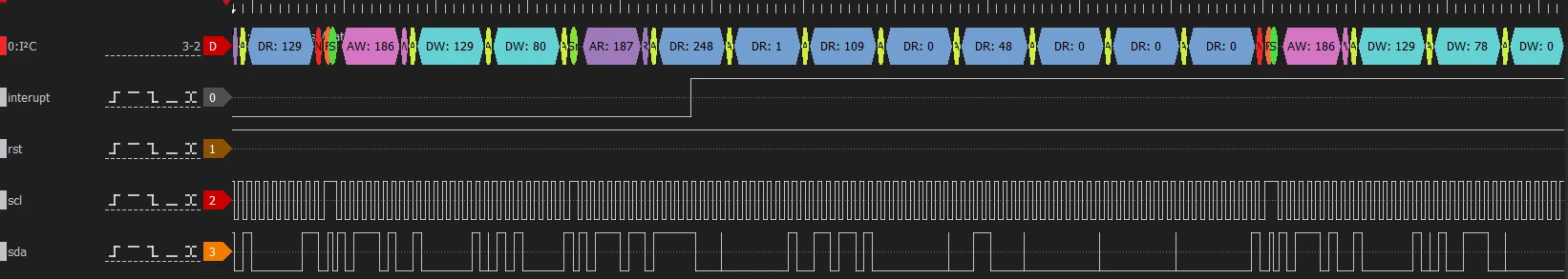

STM32F429ZI with GT911 Communication stuck with Touchgfx

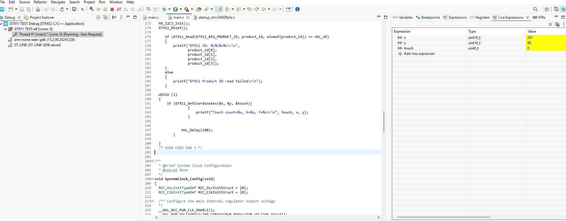

The above Logic analyzer and debugger  show a correct touch register If the simple GT911 library is used in bare bone STM32F429 but when the Code is integrated with the touchgfx and freertos of the sample STM32F429ZI Disco board then the I2C seems to get stuck and no I@C Communication happens as shown below.
Touchgfx and Freertos integration

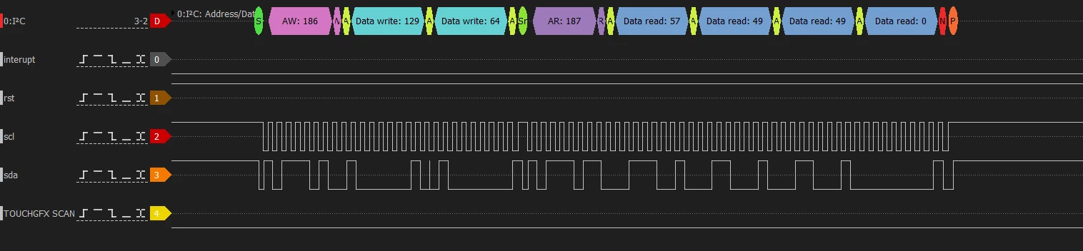

This is the initial power on

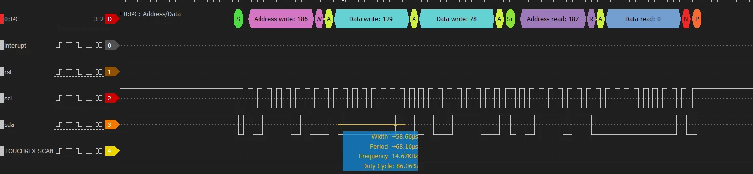

this is zoomed view of packet 1
zoomed view of packet 2

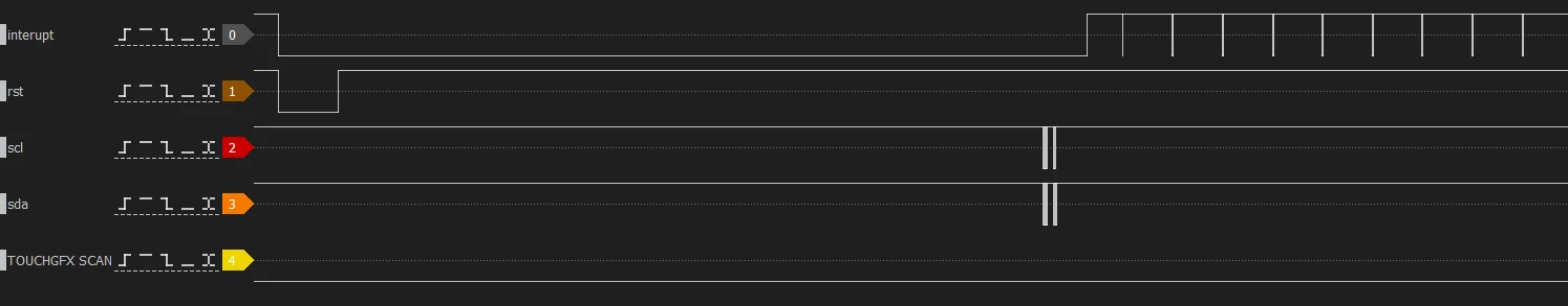

After this the interrupt is generated periodically and I2C Communication halts indefinitely
Bare Bone Code
have been attached and the Touchgfx freertos

Keep in mind no wiring or hardware changes have been done

The read coordinate function was already in the Sampletouch routine under STM32TOUCHCONTROLLER.CPP it is behaving the same in that function also.

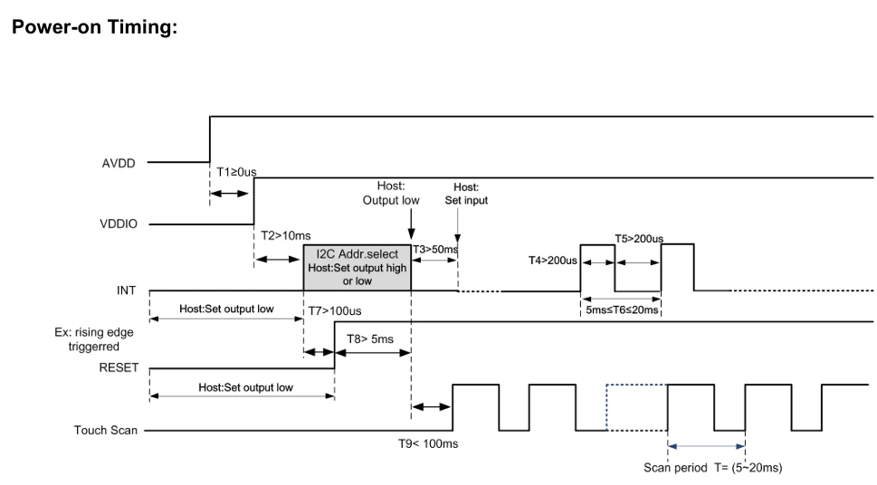

I think your problem is that you do not control the pins correctly for power-on timing. The power-on sequence can be used to change the address of the controller, which would lead to what you see. Here is a timing diagram for power-on:
You should make sure that your interrupt pin is held low when the reset pin goes high. It should be enough to enable the pull-down resistor on the pin.
