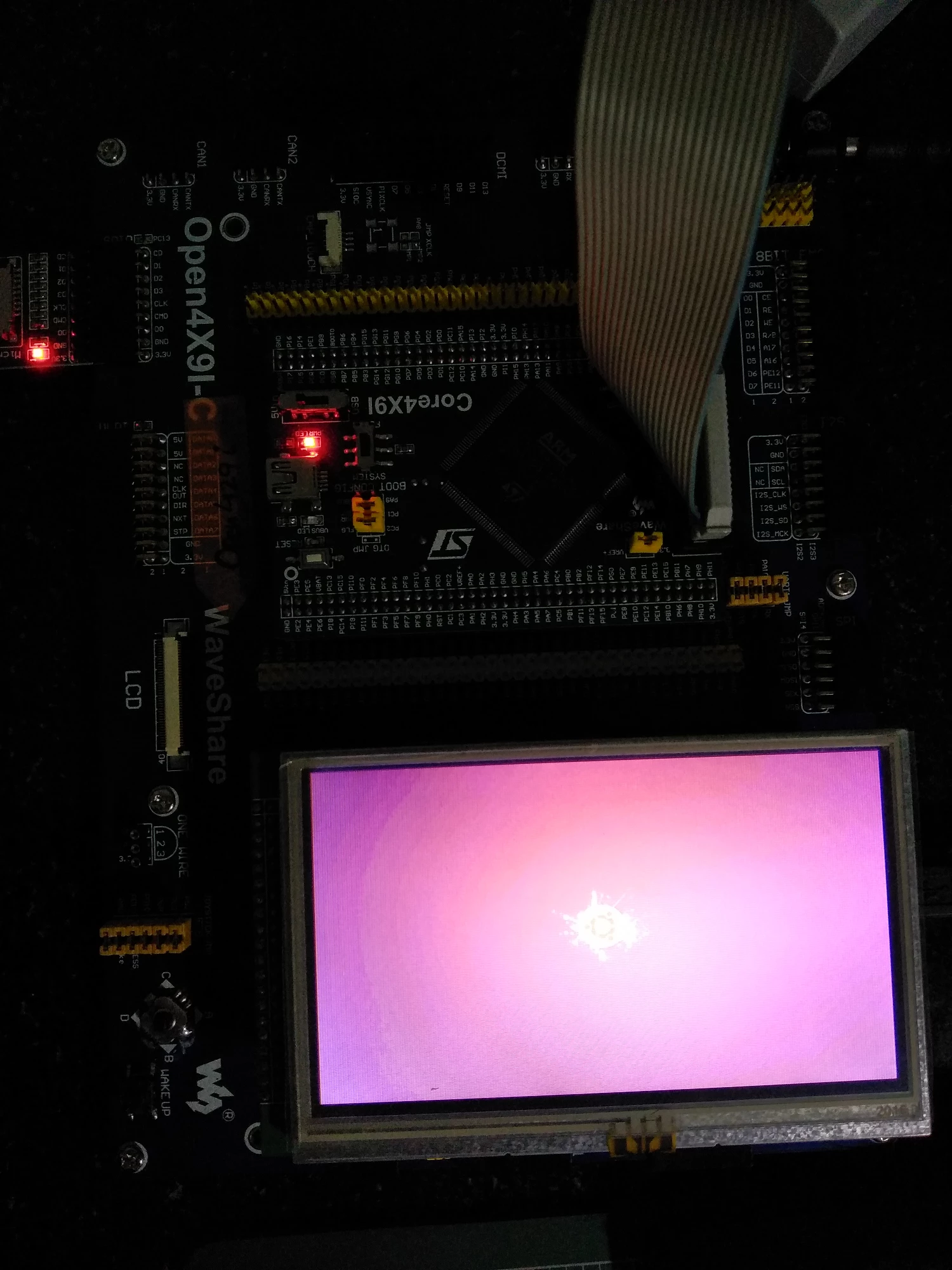

I have been trying to learn the basics of STM32 LTDC peripheral to drive a 4.3" 480 x 272 LCD using STM32F429IG mcu. I am using the Open429i dev kit by Wavehshare (https://www.waveshare.com/core429i.htm) which also has an onboard 64Mbit SDRAM (IS42S16400J).
As step 1, I got the LCD to work with the LTDC controller and I am able to display appropriately formatted (RGB565) images on it by pointing the buffer to an image array in my code, like below
So I know my LCD is good and I have configured LTDC correctly with 1 layer
2nd step, I tried interfacing with the onboard SDRAM using FMC peripheral SDRAM bank 2 and pointing the LTDC framebuffer to this address.

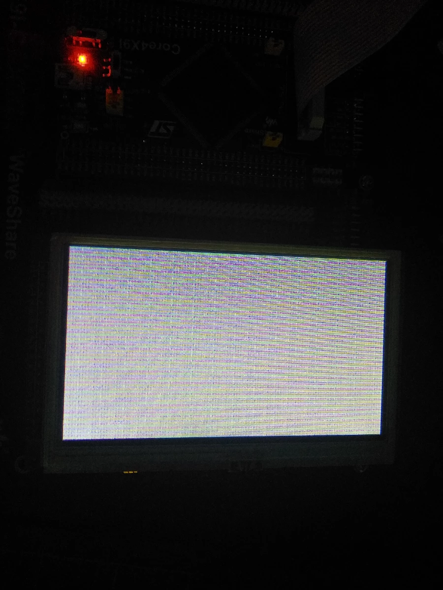

However when I do this, I get these weird colored streaks that seem to be scrolling horizontally. What I expected was the screen to be all white as I am clearing the SDRAM LTDC area to all 0xFF.
A video showing the above in action is at https://vimeo.com/289213554
I feel it's something to do with my SDRAM timing but I am not sure where to look and for what. As a test I wrote an array to the SDRAM and read it back for verification, which was successfull.

Did you ever figure out why this happened? I have the same issue, where I'm running LTDC off SD-RAM. SD-RAM is multi-bank and allows concurrent access, but even so, when I read/write to a different bank, the display gets messed up whilst that happens, and returns to normal after the read/write is completed. Any tips from what you've learned?
