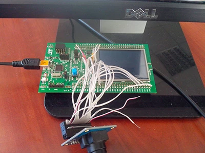

Posted on November 17, 2014 at 06:01
I want to implement DCMI on the STM32F429I Discovery using OV7670. I am using external clock of 20MHz for OV7670 clock source. I can get the frame interrupt, but cannot get the dma interrupt working. Also, no data is written to the buffer. My code is posted below. So my question is can i actually implement DCMI with STM32F429 and use lcd at the same time? I am using lcd driver without ltdc, so the dcmi pin is still not used. And, how can I write data received to DCMI to the data buffer? Any help will be greatly appreciated

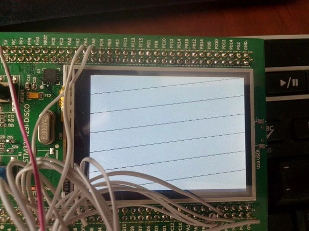

Posted on August 31, 2015 at 09:51
Everything remained as before
DMA status at the time of interruption - ''DMA Mem0 process success''

Posted on August 31, 2015 at 10:15
How did you wire the camera. Having a quick look in your code, I did not see how VSYNC is connected.
Chuev.Vladimir

What's happening here is probably only related to a different code/data/heap arrangement.
Your  #1 problem is to understand why DMA produces no errors (do not trust HAL, check registers) while the target buffer is not overwritten. Does data present in the buffer still survive the DMA transfer ?

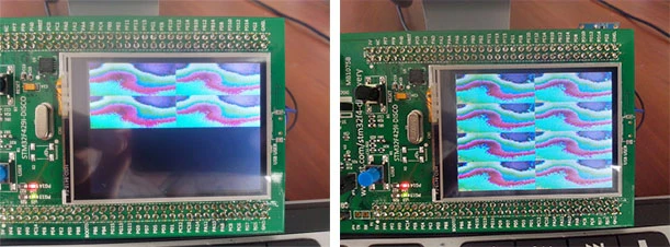

I changed I2C array with initialization registers.
Now camera shows small blocks of picture, no fullscreen. And picture became purple.
My code:

Posted on September 03, 2015 at 09:47
Sounds good. Camera sensor init is a critical part, you will require to follow the sequence provided by the sensor vendor to get the wanted resolution, frame rate, format, etc ...
