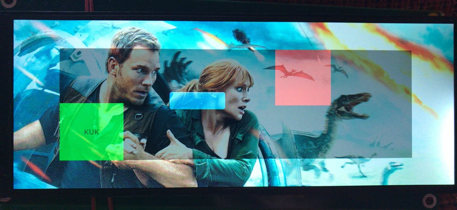

Apr 25, 2021 6:51 AM UTC
Thank for best and one example of custom 1280x480 LTDC layer 0 image in flash, 1024x320 layer 1 320kB TouchGFX framebuffer with alpha 150.

Hello MM,
thank you for the example picture. Looks great. For the current application I don't need much more than what I've already achieved with BSP drivers, but for the next project I'll try it with TouchGFX.
