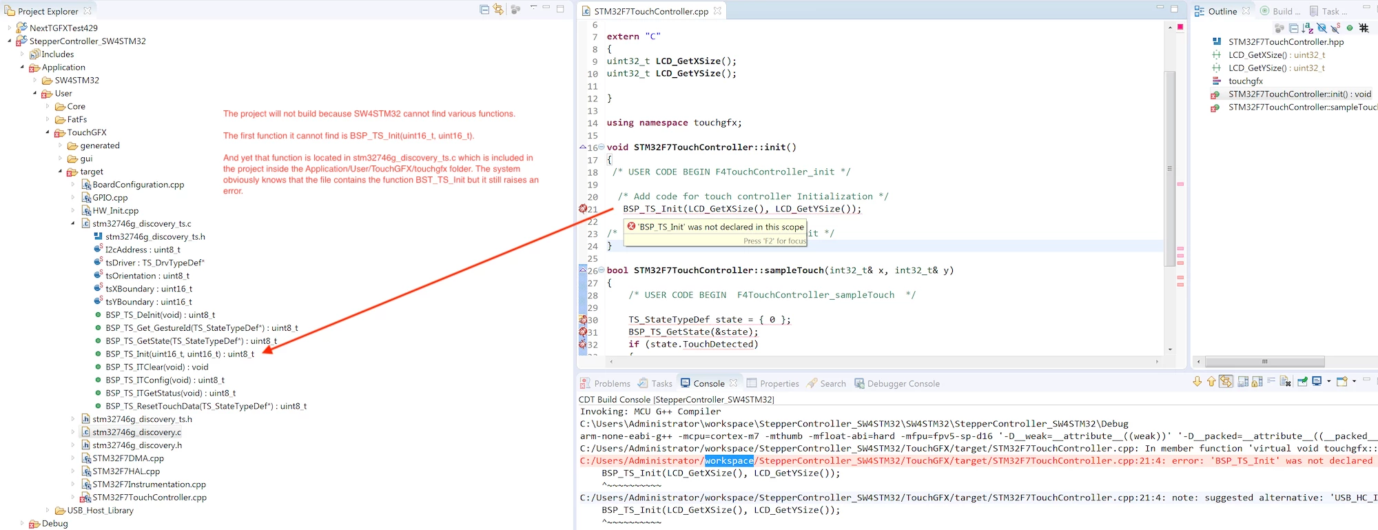

Well, I followed your tutorial as closely as I could while ignoring the differences between our target platforms, and I still get the same errors. Unfortunately, even though you place the BSP files in different places than I did, it still does not build. In my opinion, you place the files in a more logical place (inside the target folder). I placed them inside the Project/Drivers folder.
Here is a screen shot that shows very what is going wrong.
The screen shot is pretty big. I will also attach it as a file.
I'm about ready to throw a brick into my computer screen and swear off computers and programming and specifically embedded programming, SW4STM32 and ST. HA! Not really. I consider this a challenge. Eventually I know it will work. I just don't know when.
Unless you can see something idiotic that I am doing, I will post this image into a thread I have already created on the OpenSTM32.com forum. They've all ignored my previous thread, but this image seems so easy to grasp, maybe someone will help now.

@Clark Sann​ , please confirm that you have ALSO copied the following 2 files:
stm32746g_discovery_ts.h
stm32746g_discovery.h
into your project's folder named target
This step is required even though you have already dragged & dropped the same files manually as can be seen by your file structure. Only then will the raised error be resolved.
Have not tested with the STM32746g_discovery kit but gathering in theory it should work.
Please confirm and update.

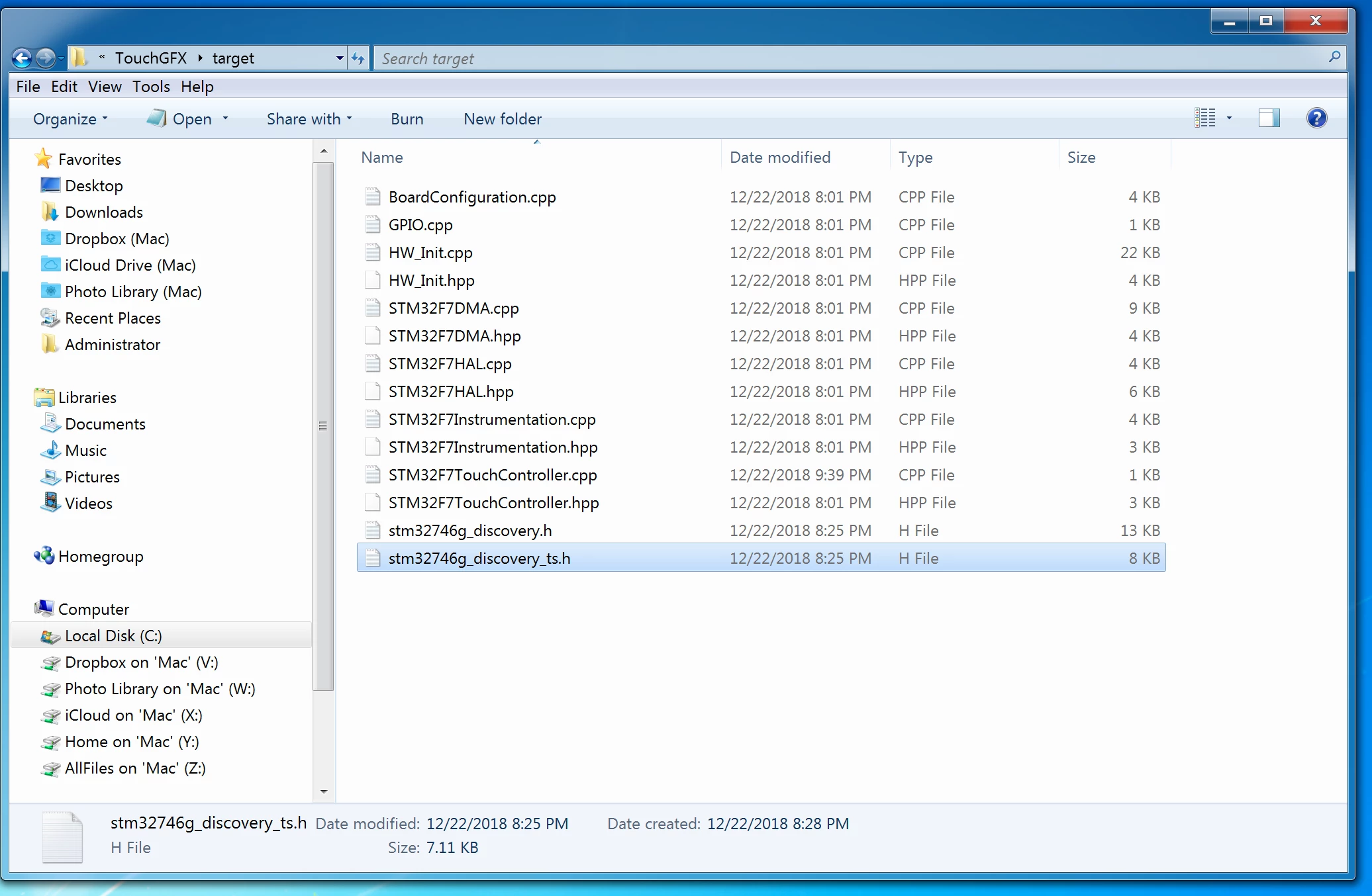

Clark Sann
Dec 23, 2018 2:00 PM UTC
Those two .h files were copied into the TouchGFX/target folder in Eclipse and using Windows Explorer. Here is the view from Windows Explorer. 0690X000006CukXQAS.png

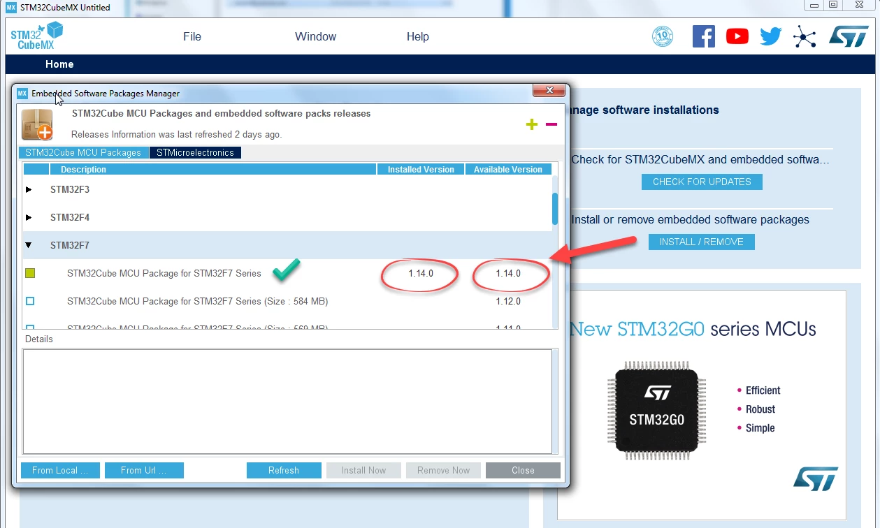

Be sure to have the latest STM32CubeF7 extracted to a local folder and also that the STCubeMX has the same latest release installed.

Clark Sann
Dec 23, 2018 6:50 PM UTC
@Mon2​ I couldn't see any significant differences between my app and yours. I just installed TeamViewer. Would you like to take a look? It is 12:50 here now. I have about an hour before I have to leave.
Nevermind....I figured out what the problems were. My app is now building and the touch screen works. OUTSTANDING! THANK YOU THANK YOU THANK YOU
Here is what I had to do to get mine to work:
  1. added FT5336.c and FT5336.h to project
  2. added Components/Common to project
  3. added stm32746g_discovery_ts.h file to STM32F7TouchController.cpp.
I will add more info later. The folder structure is so convoluted I can't figure out where the files were placed. Out of time now.
