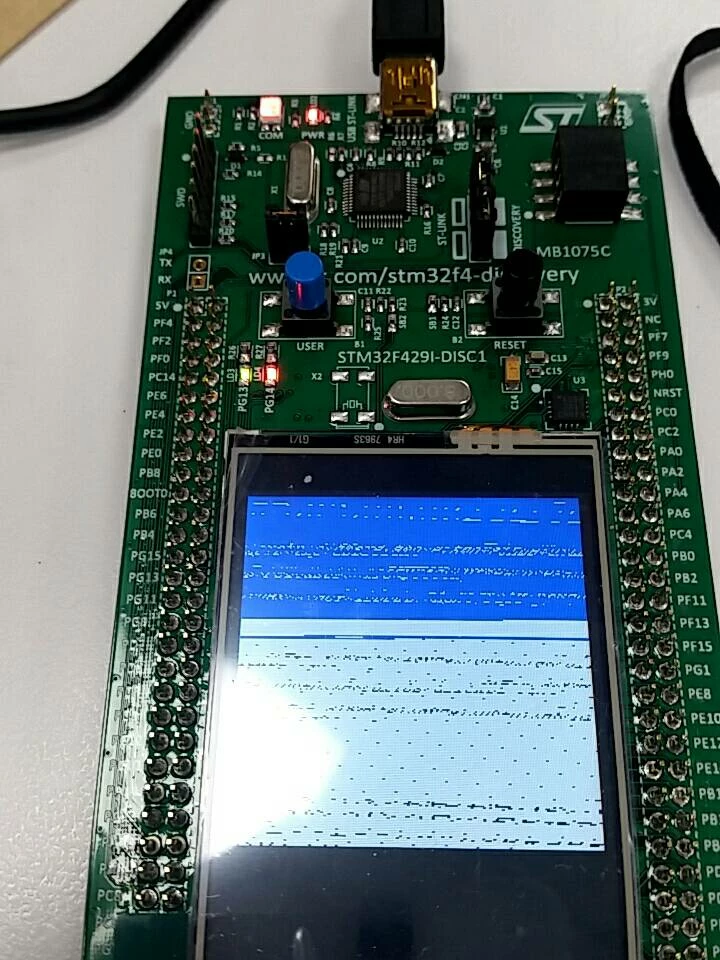

STM32F429I-DISC1 Project example BSP LCD String look like salt noise
  • December 18, 2019
  • 1152 views
Hi
I buy a STM32F4 discovery board, and I run example from ST offical github.
The Project in STM32CubeF4-master\Projects\STM32F429I-Discovery\Examples\BSP (IDE: MDK-ARM), I think the LCD will show some string, but I got some salt noise.
Other LCD examples, ex DMA2D, it works good.
Any suggest?
Thanks

I suppose there is nothing wrong with the Discovery board.
But there seems to be a bug or two in the example project. Perhaps the display orientation wrong.
Tesla DeLorean
Guru
December 18, 2019
Screen settings (horizontal/vertical​) wrong.
Make sure not the EVAL example.
Try some of the other DISCO examples.​
