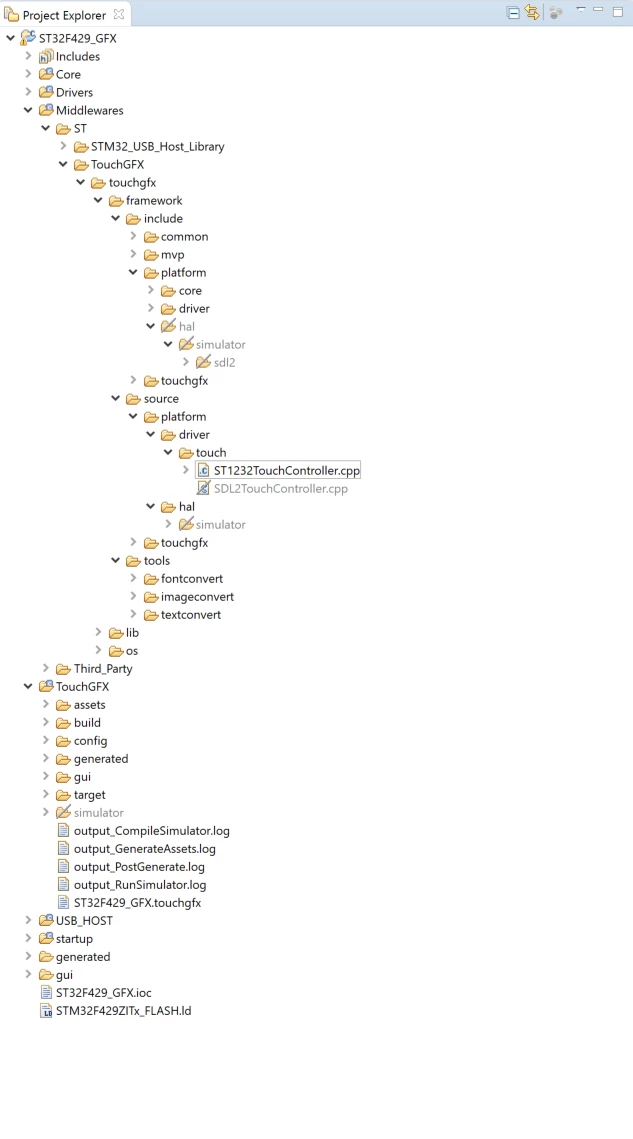

Hi All , its been almost a week that I'm trying to integrate CubMX for configuration, TouchGFX for Graphics and workbech! no success. I am using STM32F429I board.
What i could manage to do:
  • was able to configure the TouchGFX on CubeMX based on provided videos on the internet and documents. can generate the code and see the touchGFX folder.
  • followed this tutorial
https://www.youtube.com/watch?v=xZ0pPhQCQUY&t=11s
  • excluded all simulator related files and included needed path .
However, I am still facing the following error :
Regardless to the fact that i excluded all simulator related files and folder, I still getting :
"Description Resource Path Location Type
fatal error: SDL2/SDL_video.h: No such file or directory HALSDL2.hpp /touch_third/Middlewares/ST/TouchGFX/touchgfx/framework/include/platform/hal/simulator/sdl2 line 22 C/C++ Problem
would really appreciate any guidance.

Hi @Martin KJELDSEN​ , Thanks a lot for your response,
I could manage to compile the project by excluding folders as following :
Also, could upload the code and see the image on the display.
Then i followed instruction to fix the touch functionality for this board. i copied necessary driver files from CubMX and added "stm32f429i_discovery_ts.h" in "STM32F4TouchController.cpp".
modified needed lines and faced issue with this part:
BSP_TS_GetState(&state);
 if (state.TouchDetected)
 x = state.x;
 y = state.y;
 return true;
looking at " stm32f429i_discovery_ts.h"
i found this declaration:
typedef struct
 uint16_t TouchDetected;
 uint16_t X;
 uint16_t Y;
 uint16_t Z;
}TS_StateTypeDef;
so i change x to X and y to Y. this one solved!
Then i faced an issue with multiple function deceleration " void LCD_Delay(uint32_t Delay)" . it was decelerated in both , "BoardConfiguration.cpp" and "stm32f429i_discovery.c".
by removing the deceleration on one them(doesn't matter which one!) i could manage to upload the code and having the touch functionality too.
Happy by this, i tried to add a simple blink test too.
for what ever reason i could never blink the LED on the board until i removed " osKernelStart();" from the main.cpp . then the LED Blink, have the image on the screen BUT no Touch functionality.
Any suggestion?
