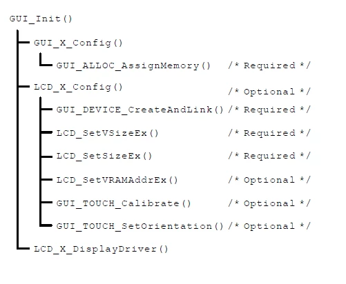

STM32F429 Stuck in GUI_init() after generation using STM32cubeMX V4.26
Posted on June 11, 2018 at 10:48
Hi guys, I'm using STM32CubeMx V4.26 to configure STM32F429 that is connected to TFT LCD. I m trying to get my TFTLCD to work with StemWin using FreeRTOS. My program compile and link smoothly without problem. Running the program in the hardware leads to an MCU stuck in the function : GUI_init()
I ve checked some similar issues and it looks to be related to the graphic library and RCC clock.
Could any one have guidance for this issue ? are there some sample code ?

Sorry, don't use Cube but should have realised it would turn on the CRC...
do you have sufficient memory allocated for freertos stack?
Have you allocated enough memory for emwin in GUIConf.c
example: ♯ define GUI_NUMBYTES xxxx

Enabling the CRC clock is required for the stemwin library to function.
Have you done this:
RCC_AHBPeriphClockCmd(RCC_AHBPeriph_CRC, ENABLE);

And do you have your LCD_Initialisation code in LCDConf.c (or its Cube+rtos equivalent)
My apologies if this is all very obvious...
int LCD_X_DisplayDriver(unsigned LayerIndex, unsigned Cmd, void * p) {
int r;
(void) LayerIndex;
(void) p;
switch (Cmd) {
case LCD_X_INITCONTROLLER: {
LCD_Initialization();                                    //Call your initialisation code here
GUI_SetScreenSizeY(VYSIZE_PHYS);
GUI_SetScreenSizeX(VXSIZE_PHYS);
// Called during the initialization process in order to set up the
// display controller and put it into operation. If the display
// controller is not initialized by any external routine this needs
// to be adapted by the customer...
r=0;
break;
case LCD_X_SETVRAMADDR:
r=-1;
break;
etc...

set breakpoint at the function
GUI_ALLOC_AssignMemory
GUI_DEVICE_CreateAndLink....
You can determine the function on which the program hangs
P.S. Bug in CubeMX
https://community.st.com/0D50X00009XkXi3SAF

emWin Init needs the CRC module enabling as it does a CRC Check on memory - this caught me out once!
Check the CRC Module is clocked and enabled, my STM Code look like this;
/** @note The emWIN GUI_Init() uses the CRC Module to perform a memory
 * check - so the CRC clock must be enabled before calling GUI_Init.
 __HAL_RCC_CRC_CLK_ENABLE();     /* Enable the CRC Module */
