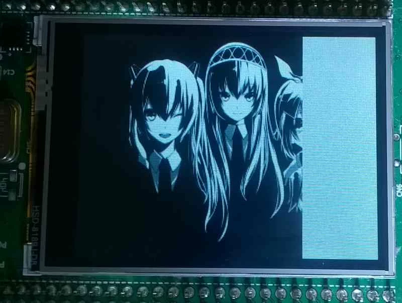

I have same problem. On the right side is white area.
In ILI9341:
I changed register 0x36 value (Row/Column exchange) and start/end address for Column and page (register 0x2A and 0x2B).
In STM32F429 LTDC:
#define
LCD_HSYNC 0x0A // 10
#define
LCD_HBP 0x14 // 20
#define
LCD_HAREA 0x140 // 320
#define
LCD_HFP 0x0A // 10
#define
LCD_VSYNC 0x02 // 2
#define
LCD_VBP 0x02 // 2
#define
LCD_VAREA 0xF0  // 240
#define
LCD_VFP 0x04 // 4
#define
HSW (LCD_HSYNC - 1)
#define
AHBP (LCD_HSYNC + LCD_HBP - 1)
#define
AAW (LCD_HSYNC + LCD_HBP + LCD_HAREA - 1)
#define
TOTALW (LCD_HSYNC + LCD_HBP + LCD_HAREA + LCD_HFP - 1)
#define
VSH (LCD_VSYNC - 1)
#define
AVBP (LCD_VSYNC + LCD_VBP - 1)
#define
AAH (LCD_VSYNC + LCD_VBP + LCD_VAREA - 1)
#define
TOTALH (LCD_VSYNC + LCD_VBP + LCD_VAREA + LCD_VFP - 1)
// LCD Synchronous timing
LTDC->SSCR  = HSW << 16;
//Horizontal Synchronization Width
LTDC->SSCR |= VSH;
// Vertical Synchronization Height
LTDC->BPCR  = AHBP << 16;
// Accumulated Horizontal back porch
LTDC->BPCR |= AVBP;
// Accumulated Vertical back porch
LTDC->AWCR  = AAW << 16;
// Accumulated Active Width
LTDC->AWCR |= AAH;
// Accumulated Active Height
LTDC->TWCR  = TOTALW << 16;
// Total Width
LTDC->TWCR |= TOTALH;
// Total Height
And the result is:

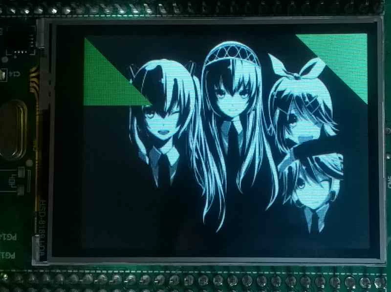

But if I changed:
#define
LCD_VAREA
0xF0
+80
// 240+80 = 320
I got:
Now, I am confused. What do you think?
