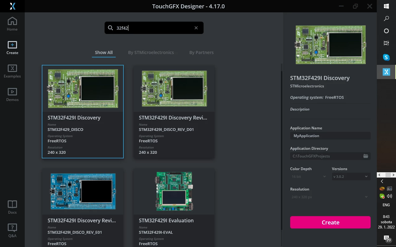

MM..1
January 29, 2022
I add only one info for your TGFX start here is list of boards filtered ...
0693W00000JNnTdQAL.pngand after choice board check on right Versions and try more
you have right GUI is in latest TGFX limited, try older TGFX 4.13 or 4.16.1
