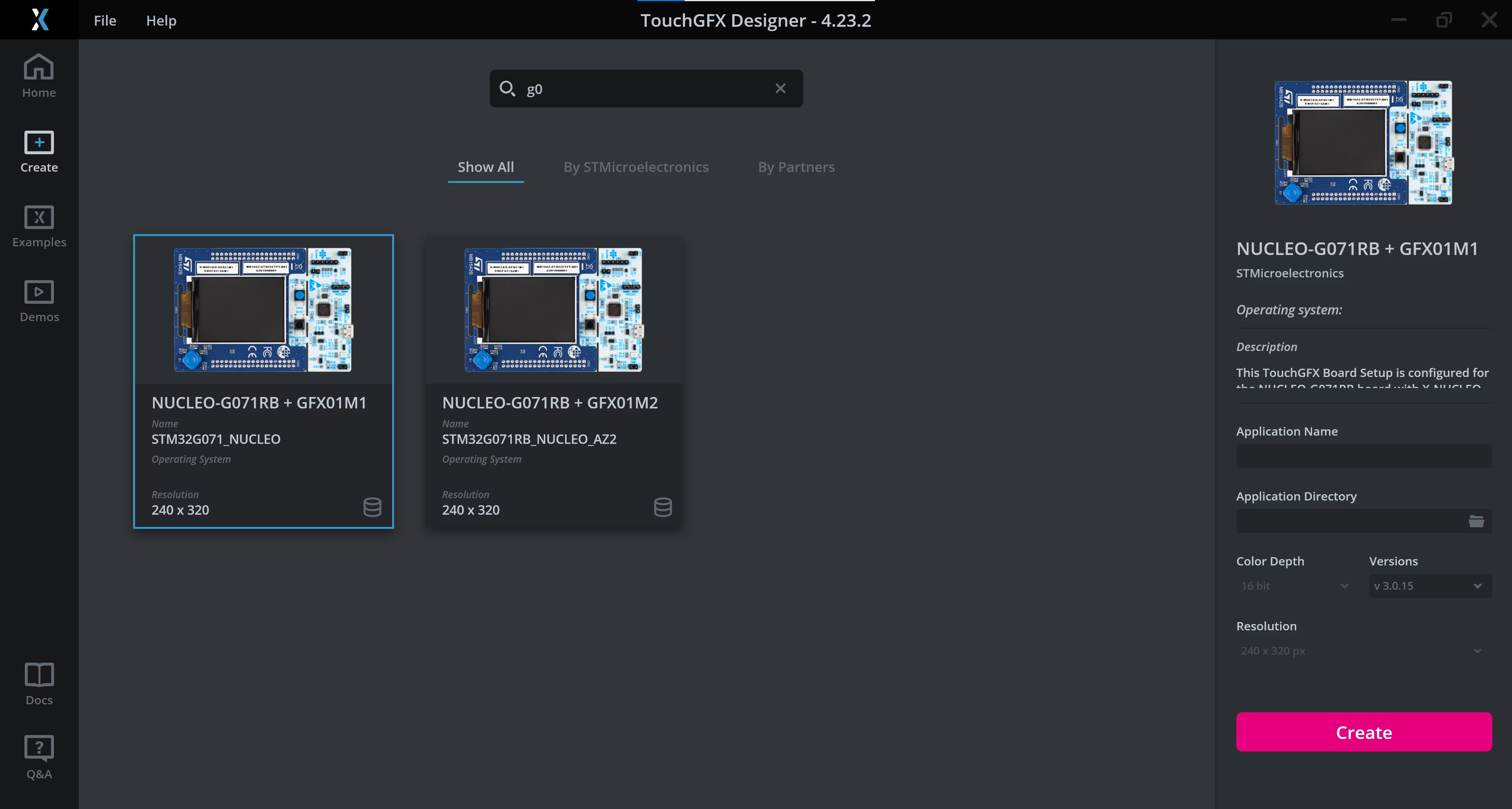

Hi, I've been trying a project focusing on GUI display on TouchGFX GFX01M1 with STM32f411RET6 NUCLEO board. I have seen videos in youtube related to TouchGFX and they say that there is a need for FMC interface and LTDC in STM32CubeIDE. But for STM32f411RET6 board there is no FMC and LTDC in STM32CubeIDE, which is essential for interfacing TouchGFX with STM32f411RET6 board. I have thought of using SPI pins but for that I'm needing TFT ili9341 display. I want to implement my project with TouchGFX GFX01M1 only. Kindly suggest me a correct way to do this.

Hello @viha_123 ,
First of all, I should mention that the display module you are considering using is called X-NUCLEO-GFX01M1 , and it is not related to TouchGFX.
As you mentioned, you need to use SPI to communicate with your display module, and the process for doing that differs from using LTDC. There is a documentation available here to show you the process required for dealing with SPI or FMC displays.
Unfortunately, there is no TouchGFX Board Setup available for the STM32F411, hence you need to start a new project from STM32CubeMX and proceed from there. There is a comprehensive tutorial in the TouchGFX Board bring up documentation that can assist you throughout this journey.
It is also worth mentioning that there are a few TouchGFX Board Setups that use SPI displays, which you can use as inspiration for your custom project. For instance, you can take a look at STM32 NUCLEO-G071RB or STM32 NUCLEO-WB55RG
STM32 NUCLEO-G071RB TouchGFX Board SetupSTM32 NUCLEO-G071RB TouchGFX Board Setup
I hope this helps you. Don't hesitate to ask more questions
