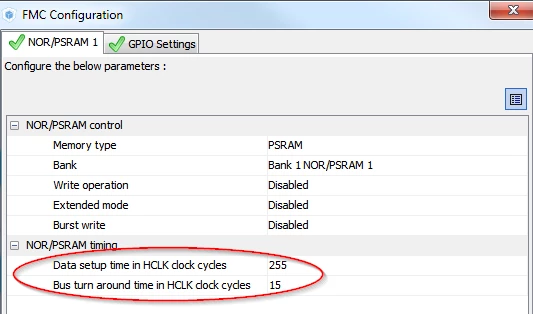

Hi!
In your first code, I think the culprit were, that you used FSMC_ExtendedMode_Disable ,although you gave FSMC_AccessMode_D.
I think you need to enable extended mode, if you plan to use anything besides AccessModeA.
Have a look at the datasheet regarding this part.
In your newer code, it seems to be corrected, and you do mention an 8x improvement, so thats good.
But I think you forgot to set the
timing.FSMC_BusTurnAroundDuration
See that you give it some reasonable value.
As a matter of fact, the stm32cubemx comes in handy to check, what exactly youl should care about while initializing a peripheral.0690X000006054EQAQ.png

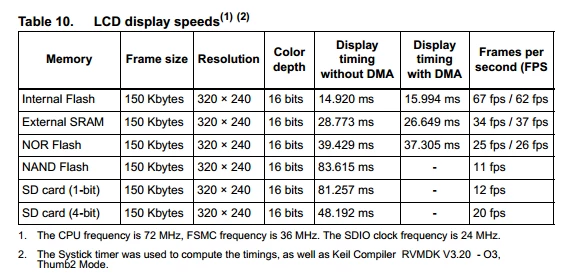

1. Now I am able to get 12.5 FPS on 800x480, this
http://www.google.co.in/imgres?imgurl=http://www.emcu.it/STM32/STM32-TFT/TFT-FMC-2.png&imgrefurl=http://www.emcu.it/STM32/STM32-TFT/STM32-TFT.html&h=511&w=619&tbnid=Bc7-T6MxHAFFsM:&zoom=1&docid=O0RaxZxNrbdReM&ei=dKCqU9OyG5CfugTLj4HwCQ&tbm=isch&ved=0CBoQMygAMAA&iact=rc&uact=3&dur=297&page=1&start=0&ndsp=18
 describe one is able to achieve 62 FPS on 320x240 resolution. So for this TFT resolution I will get ~25FPS just half what they achieving. What may be the reason? thing that I figure out is distance of wire between TFT and discovery board? my wire bus is about 25cm.

rigomate2
Jun 25, 2014 8:23 PM UTC
Posted on June 25, 2014 at 22:23
I checked that link, and that's for a STM32F1 series running on 72MHz, whereas the FSMC clocked at 36MHz.
I think you should tighten the timing delays. Just play around if you will, or look up the SSD1963 datasheet and try to read the allowed tightest timings.
