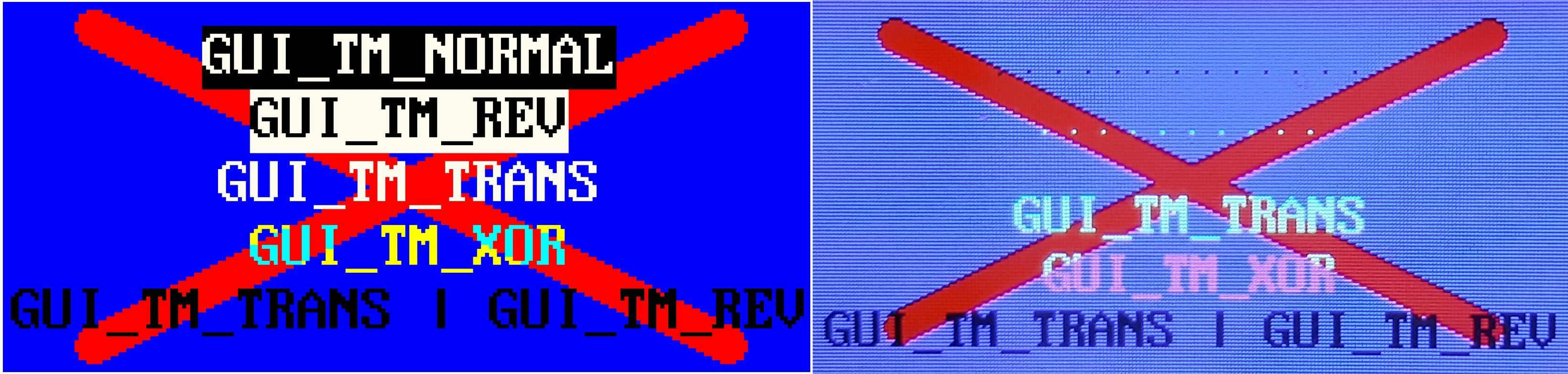

STemWin v5.44 do not support NT35510 based TFTs. But it possible to rewrite LCDConf_FlexColor.c and TFT working good. But problem found with text output by GUI_ functions. This pcs of code from STemWin manual working wrong and produce the result like in the pic. On the pic left is right output, on the right - from my TFT. What is wrong here?
 // UM03001_v6.18.pdf page215 text output snippet
 GUI_SetFont(&GUI_Font8x16);
 GUI_SetBkColor(GUI_BLUE);
 GUI_Clear();
 GUI_SetPenSize(10);
 GUI_SetColor(GUI_RED);
 GUI_DrawLine(80, 10, 240, 90);
 GUI_DrawLine(80, 90, 240, 10);
 GUI_SetBkColor(GUI_BLACK);
 GUI_SetColor(GUI_WHITE);
 GUI_SetTextMode(GUI_TM_NORMAL);
 GUI_DispStringHCenterAt("GUI_TM_NORMAL", 160, 20);
 GUI_SetTextMode(GUI_TM_REV);
 GUI_DispStringHCenterAt("GUI_TM_REV", 160, 36);
 GUI_SetTextMode(GUI_TM_TRANS);
 GUI_DispStringHCenterAt("GUI_TM_TRANS", 160, 52);
 GUI_SetTextMode(GUI_TM_XOR);
 GUI_DispStringHCenterAt("GUI_TM_XOR", 160, 68);
 GUI_SetTextMode(GUI_TM_TRANS | GUI_TM_REV);
 GUI_DispStringHCenterAt("GUI_TM_TRANS | GUI_TM_REV", 160, 84);

As you can see some text output functions is work OK, therefore CRC is enabled.
I test most of the STemWin v5.44 functionality (windows, buttons, text vidgets...) and found it's all working good.
There are only TWO things do not work: text output with GUI_TM_NORMAL and GUI_TM_REV modes.
It can be subject of NT35510 low level init, but I not so awesome to find a point of this problem....

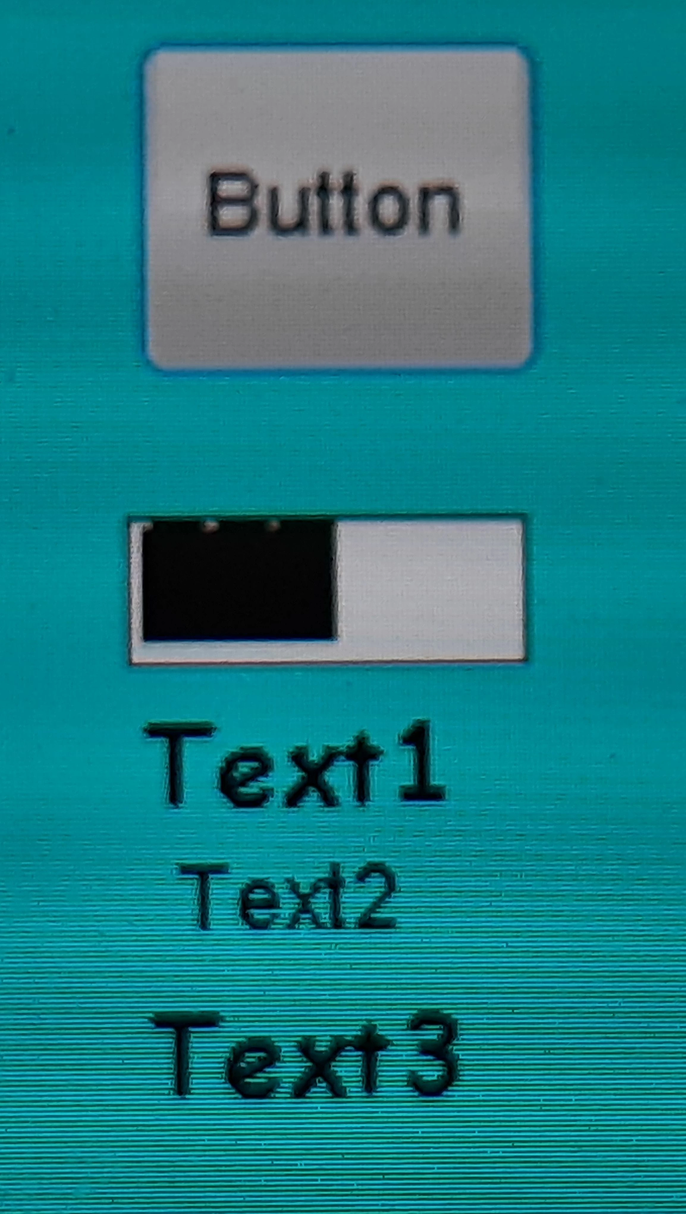

And additional example, pic from TFT included. It contain button, Edit field and three Text fields with the different fonts. All is making in GUIBuilder. Edit field have the initial text "123" inside which is displayed wrong...

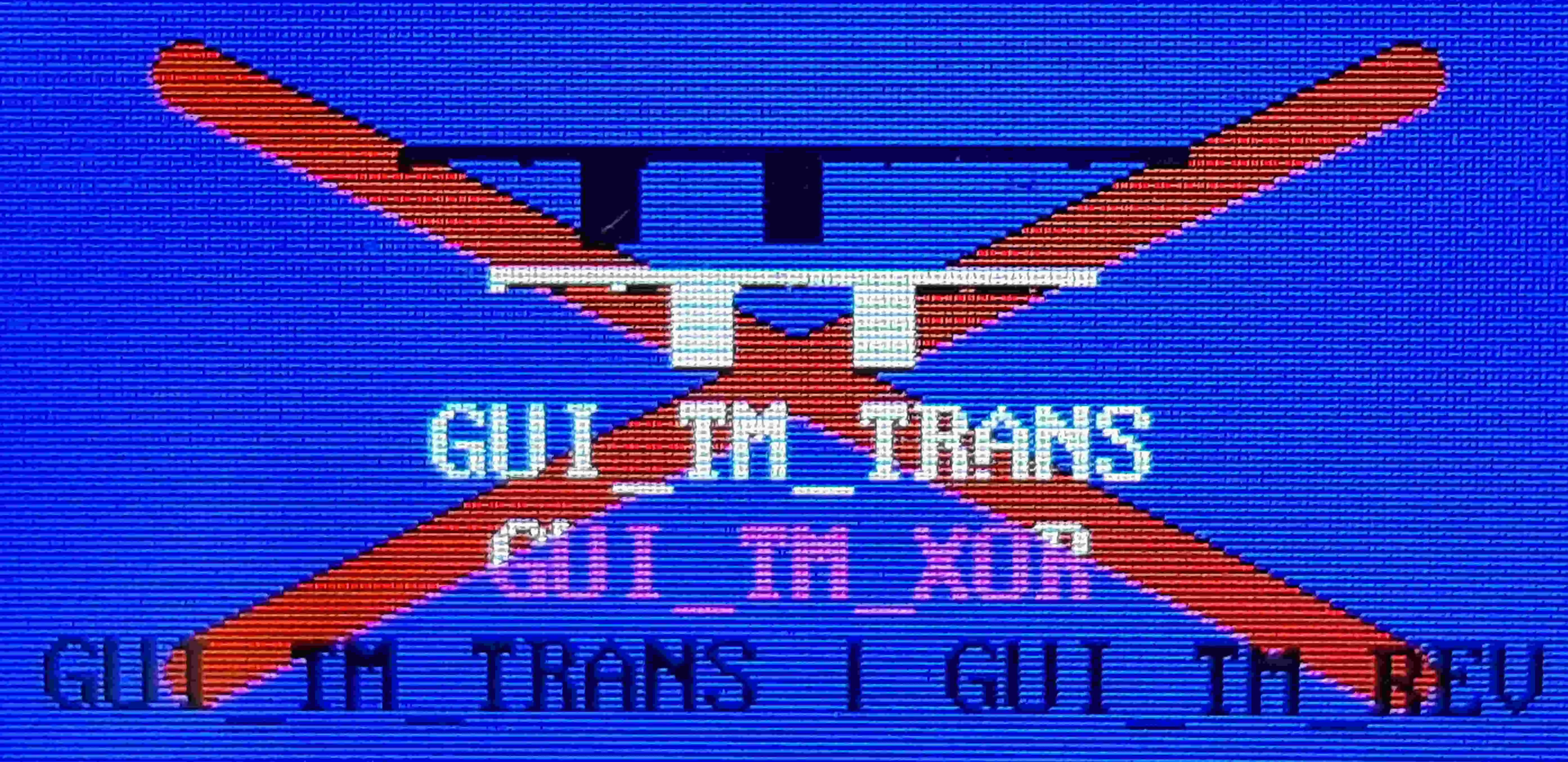

June 1, 2021
Finally, we could receive the following result for text output example from the user manual:
