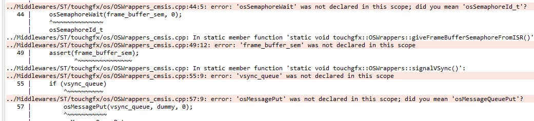

I think this is the most important problem, TouchGFX uses older version of FreeRTOS but STM32CubeMX adds newer version of FreeRTOS and I am not able to select FreeRTOS version.

About the FreeRTOS version mismatch issue, I tried many things like using built-in project (which was using older FreeRTOS version) in TouchGFX Designer as @JohanAstrup suggested, I opened my old working Touch Screen project (STM32CubeMX had to install older version of FreeRTOS and TOUCHGFX software packs). I am not sure what really solved the issue but there is no compilation error anymore. Thank you.

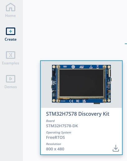

I would recommend you to have a look at the STM32H7S78-DK TBS available in TouchGFX Designer, which is using FreeRTOS.
Best regards,
Johan
