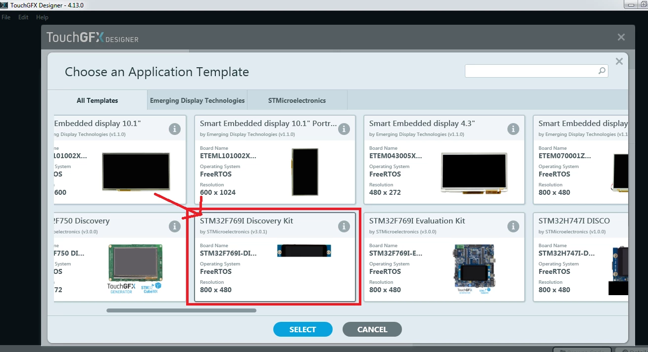

Best answer by Karan 123
Why don't you like this ?
Open TouchGFX -> Change Application Template -> Choose STM32F769I-DISCO Kit .. and Draw something.
Run Simulator then Run Target...
 That will automatically generate setting of STM32CubeMX which you are manually doing.
Hope this helps..
Karan

Hello Karan,
thank you! I only looked at the "online" section of touchgfx and this was nearly empty. Now I can modify the ioc, however, the created IAR v8 project file is for a newer IAR version than 8.30.
After manualy editing the ewp file, I can compile, upload and debug.
Thanks again!
