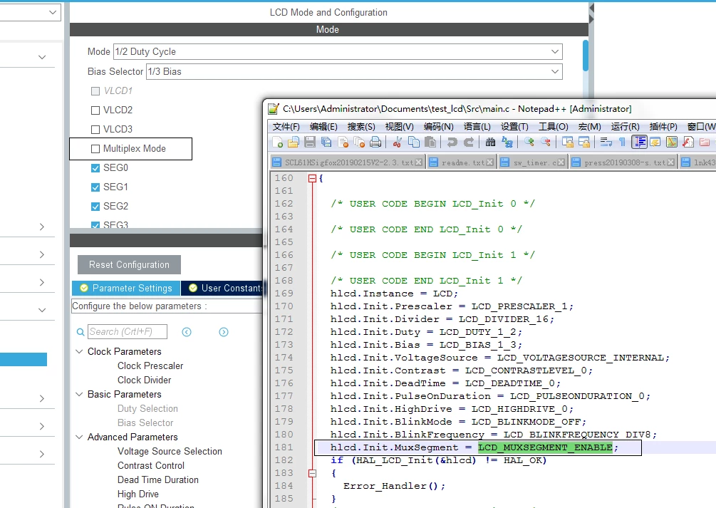

Hi,there is a bug of CubeMX I Found:
I’m using STM32CubeMX5.1.0,and STM32CUBE_FW_L0_V1.11.0
when creating a project for stm32l073, In ‘LCD Mode and Configuration’ dialog, ‘Multiplex Mode’ checkbox takes no effect. Whether it is checked or not, CubeMX always generate code with multiplex mode enabled.

​Hello @CGuo​
Thank you for the feedback, this is reported internally for further check.
