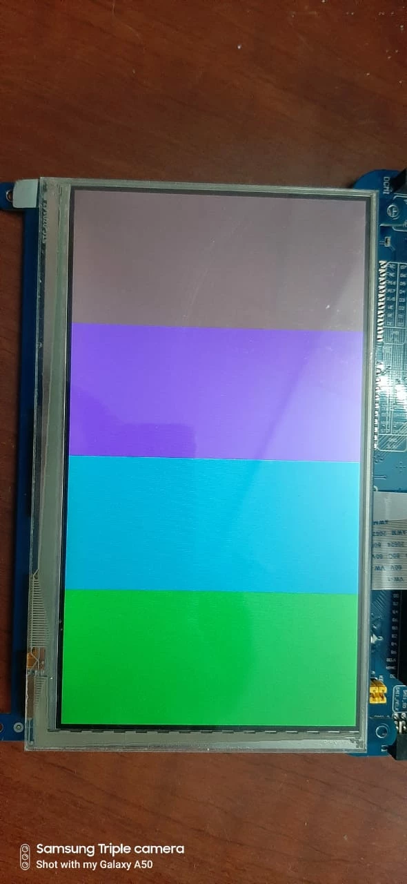

After upload ( Debugging) What's my display shows image mentioned bellow for your reference .

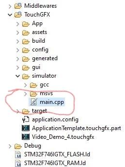

0693W00000BadUzQAJ.jpgAnd in STM32Cube IDE main.cpp file show hide, that screen short also attached below

At 2 main.cpp is only for PC Simulator and in CUBE is excluded OK

As first you comment out start RTOS and in main test your framebuffer and LTDC config.
For example in main while wait press button and fill framebuff with an colour, then next usw.
And when you use custom display you cant find display driver, but you need WRITE one.
When you connect RGB display then your connector need all signals and too init over for example SPI ...
