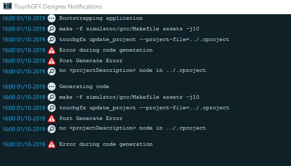

@Martin KJELDSEN​ 0690X000009jtzeQAA.pngActualy I created my project with STM32CubeIDE. I selected the 469i-disco board.
Out of the IDE I started the touchGFX to create my GUI.
Now i tried to start touchGFX again to configure my GUI. Unfortunately I am now not able to generate code.

Hi @Fab_0815​,
The current versions of CubeIDE + TouchGFX are not stable. What you're missing is actually a patch to the project updater (since TouchGFX Project updater does not understand CubeIDE projects - Notice how it is the post generation that fails. It actually patches the CubeIDE project file - .cproject. Currently, it thinks the project is Atollic/AC6).
Download this gem, open your TouchGFX environment and type "gem install touchgfx-cli-4.10.1.gem". This will give you a new version of the gem that understands CubeIDE project files.
http://sw-center-st-com.s3-eu-west-1.amazonaws.com/touchgfx/TouchGFX/Evaluation/4.10.0/touchgfx-cli-4.10.1.gem
/Martin

@Martin KJELDSEN​
Alright, TouchGFX is now working again.
Thaks for that advice!

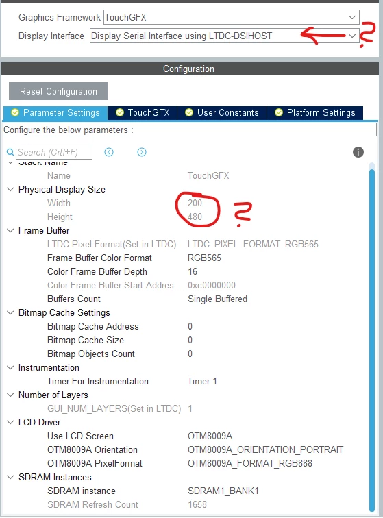

Now again to the basic problem.
I found a window with some suspicious parameter.
The physical display size is wrong, but i am not able to change the value?!
Futhermore, what about the Display Interface?
Is the Setting 'Display Serial Interface ....' correct?
Maybe take a look at the attached config.

I got it finally!
I found this post: https://community.st.com/s/question/0D50X0000Avh5Nq/stm32cubeide-touchgfx-configuration-on-32f469idiscovery
Thanks to the community member SbubaBoy who published this git repository: https://github.com/Scubaboy/SMT32F7LCDDisco/tree/master/STMF4DISCOCubeIDE
I checked every configuration of my project and adjusted the necessary ones.
