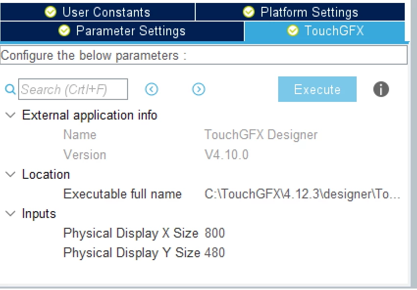

STM32CubeIDE with TouchGFX 4.12.3
I have several errors while generating my code.
A few errors i am able to solve with excluding the simulator files from my project.
But now i have a new error with an undifened reference.
../TouchGFX/generated/fonts/src/GeneratedFont.cpp:12: undefined reference to `touchgfx::ConstFont::ConstFont
Do you have any workaround for me to solve this error?
EDIT:
I found in the CubeMX file the expected version 4.10 .
Maybe this could be a problem by generating the code?!

CubeMX does not generate TouchGFX code. We asked for the "External application info" description to be modified - It wants to tell you what the "minimum" required version is.
Did you remember to press "Generate code" in the designer?
/Martin

Yes, I created a new project with the CubeIDE opened touchGFX trough the IDE.
I created a simple GUI and generated the code.
After excluding the simulation files and try to build the error appeard.
I saw that there is a new update for the IDE.
I will update my IDE now and take a look if it works with it.
