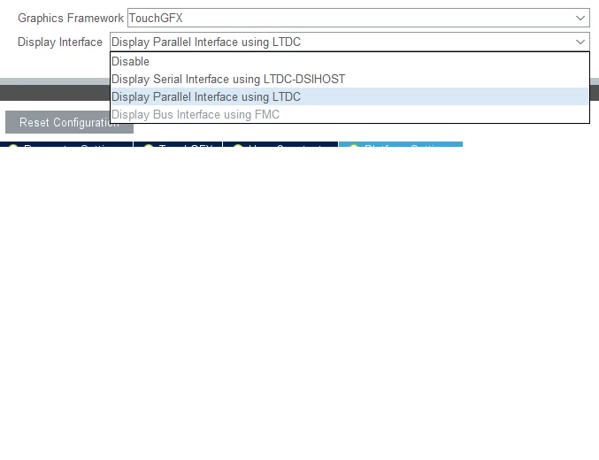

Hi
I have followed this guide for the F7 to help setup an equivalent environment for the 32F469IDISCOVERY
https://www.youtube.com/watch?v=VOs2LYO7wSA
However I don't know which pin to select for the LCD reset and which protocol option to use:
Can anyone please advice?
Thanks
Robin
21 replies
AAhar
June 9, 2019
hi the 32F469IDISCOVERY use serial dsi host lcd
and i think the reset pin is j15
(the parallel options is usually for rgb screens )

Hi, Thanks for the advice the only pins available in the IDE for the LCD reset are:
PB2, PD4, PD5, PE2, PE3, PG6, PH7, PK3, PB0, PA3
Which of these if any map to J15?
AAhar
June 10, 2019
sorry I got confused between the 32F469IDISCOVERY  to 32F769IDISCOVERY  in the f7 its j15.
and it seems that pin is PB0 because all the others are audio,leds,etc ..
good luck

Following the help so far I have set the display connection protocol to serial and assigned PB0 as the reset pin. I have been able to compile and build an image. I have loaded the image on the board using STM-LINK all good so far. When the debugger takes over the four LEDS light but the display is blank. Now I've placed a break point in the TouchGfx code on the Screen1ViewBase::Screen1ViewBase() constructor but the breakpoint is not being triggered.

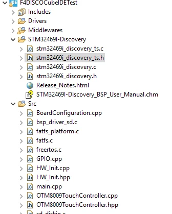

senthil

../Src/OTM8009TouchController.cpp: In member function 'virtual void OTM8009TouchController::init()':
../Src/OTM8009TouchController.cpp:19:5: error: 'BSP_TS_Init' was not declared in this scope
   BSP_TS_Init(LCD_GetXSize(), LCD_GetYSize());
../Src/OTM8009TouchController.cpp: In member function 'virtual bool OTM8009TouchController::sampleTouch(int32_t&, int32_t&)':
../Src/OTM8009TouchController.cpp:27:5: error: 'TS_StateTypeDef' was not declared in this scope
   TS_StateTypeDef state;
../Src/OTM8009TouchController.cpp:28:24: error: 'state' was not declared in this scope
    BSP_TS_GetState(&state);
../Src/OTM8009TouchController.cpp:28:24: note: suggested alternative: 'static'
            static
../Src/OTM8009TouchController.cpp:28:7: error: 'BSP_TS_GetState' was not declared in this scope
make: *** [Src/subdir.mk:91: Src/OTM8009TouchController.o] Error 1
make: *** Waiting for unfinished jobs....
"make -j4 all" terminated with exit code 2. Build might be incomplete.
11:30:54 Build Failed. 6 errors, 1 warnings. (took 4s.613ms)

Couple of things to check first does your project contain the following source items.
Secondly I noticed your make command was 'make -j4 all' I'm using 'make -j12 all' also what version of make are you using?
