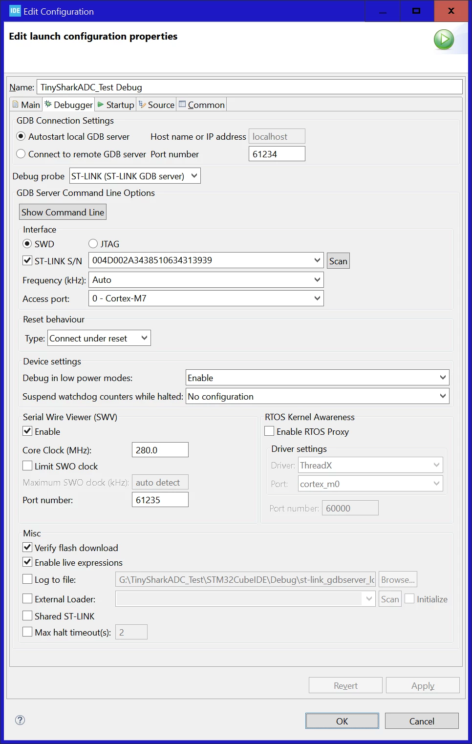

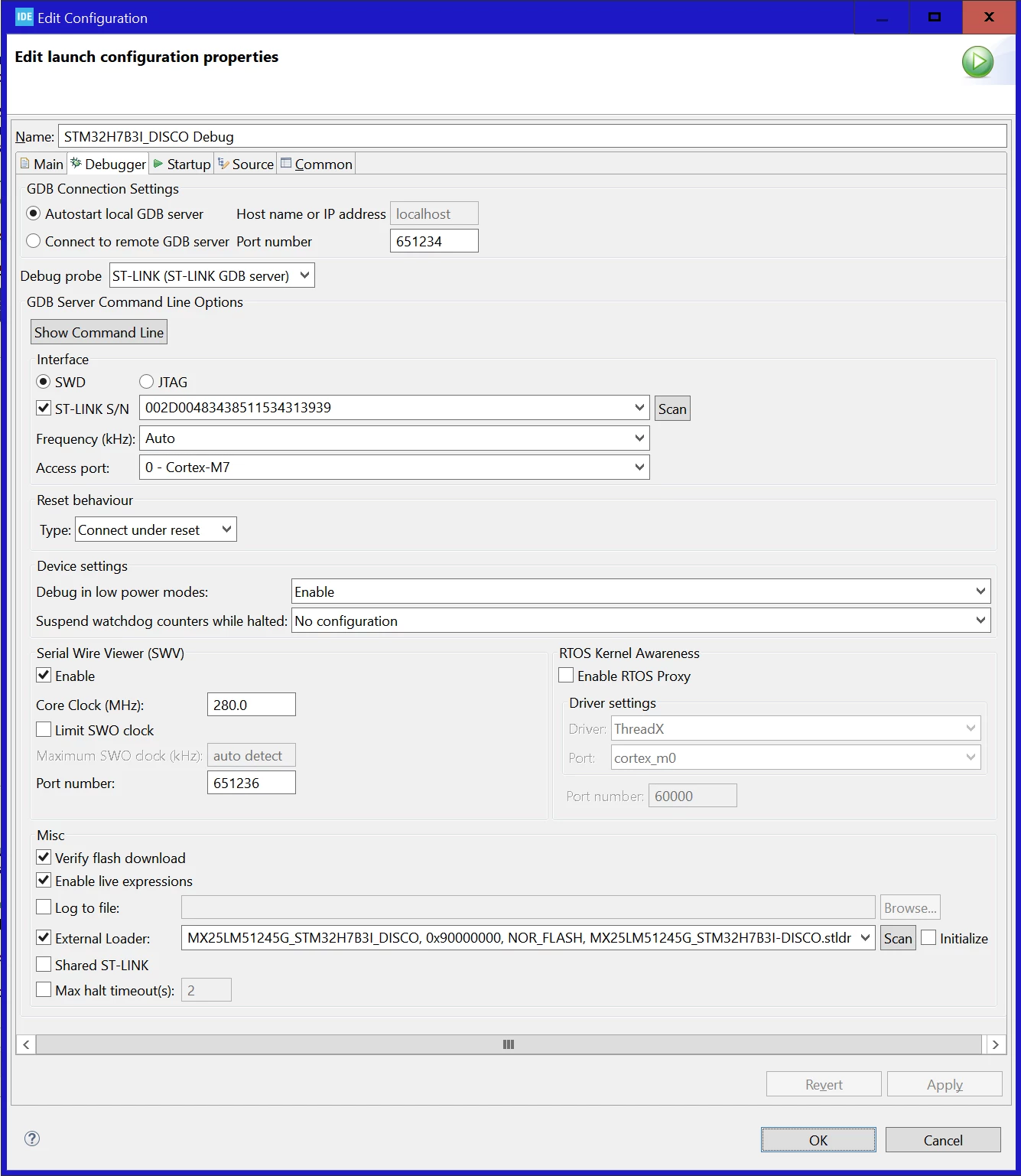

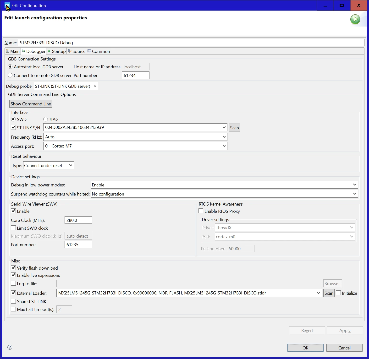

I have three projects, running on an STM32H7B3I-DK Discovery board.
They Are:
Complex - Using TouchGFX, a lot of I/O, timers, ADC's I2C, SPI and the other project is simple using only the ADC's. Throws SWV error
Simple   - No TouchGFX using ADC 1 and ADC 2 Only No SWV Error
Simple   - Using Touch GFX and no other I/O No SWV Error
When I debug the complex project I get an error: "Failed To Enable SWI - SWV will be disabled for this debug session" When I debug the simple project the error does not occur.
Obviously it is something in the build of the complex project that is causing this. The debug settings are identical for each project and are shown in the screen shots attached.

I turned logging on in the debug config, but it didn't produce the file listed in the console output:
c:\users\admin\appdata\local\temp\stm32cubeprogrammer_a35960.log
There was a file called LWSDebugOut.txt created at the same time as the debug session. It was 11 MByte and too large to attach.

Markus GIRDLAND
Markus GIRDLANDBest answer
Apr 26, 2022 8:03 AM UTC
Hello there,
I believe the problem might be in the port number. In the STM32H7B3I_DISCO project the port number 651234 is used instead of the default 61234 which makes the port number way too big.

Garnett.Robert
Senior III
Apr 27, 2022 3:44 AM UTC
Hi Markus,
Yep! You are right.
I must have had another senior's moment.
I had a support ticket on this, could you close it for me please.
