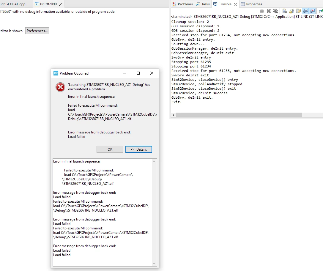

Hi there !
I start to work with touchgfx 4.21.1 and i create my first program. I use (is the first time) STM32CubeIde i compile the program and everythingh work but when i try to download to my nucleo borard i receive this error message . I searc in internet i try a lot of stuff but without success . Please some one can help me ?
Thanks a lot
Sergio

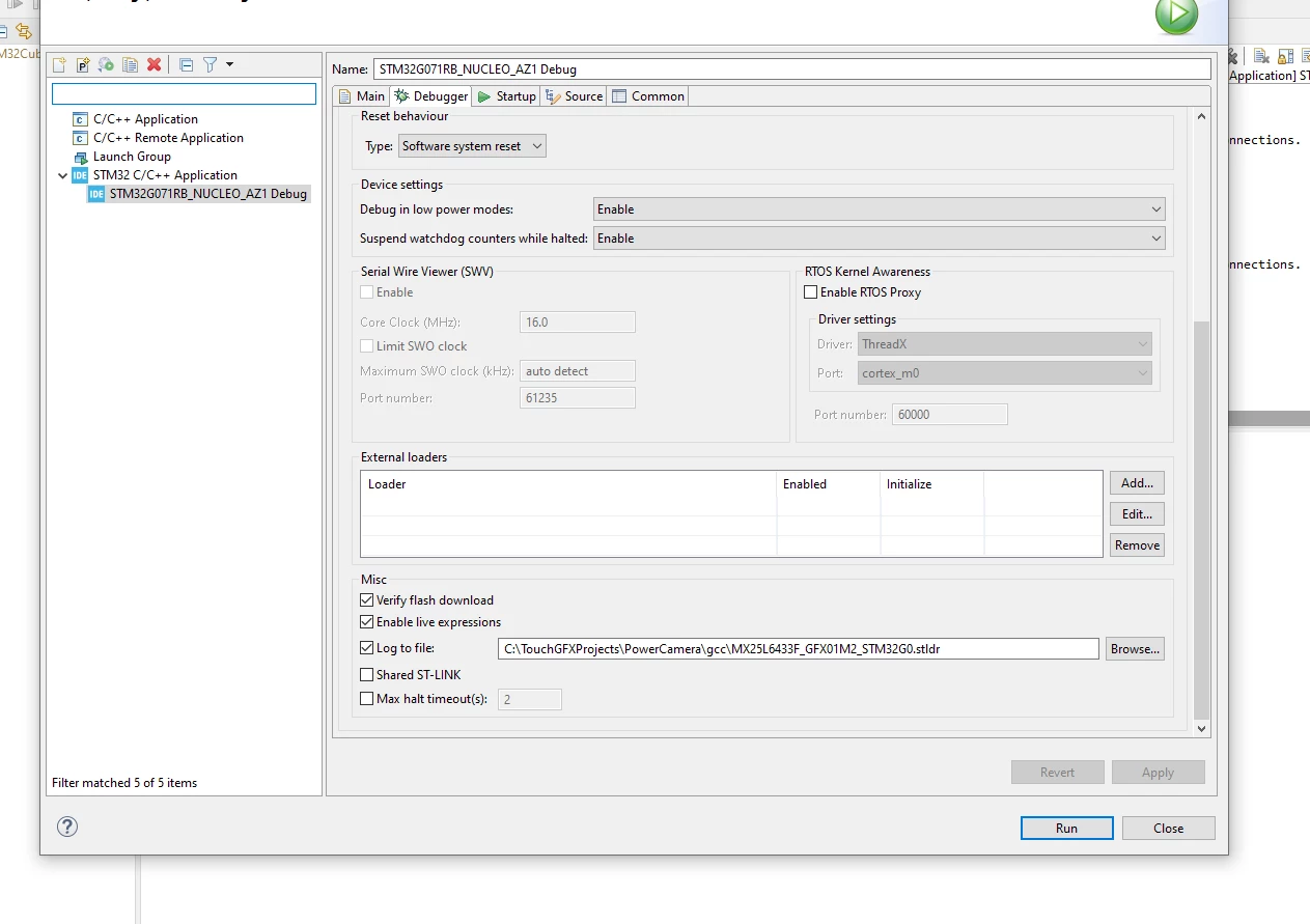

Hello @SGian.1​,
In your debug configuration you selected your stldr file in "Log to file" which is not the right place, as this is meant for a txt file which will receive the debug log. Actually it might have corrupted your file so I suggest you create a new touchgfx project which will generate a new stldr file. Then copy the file to ...\STM32CubeIDE\plugins\com.st.stm32cube.ide.mcu.externaltools.cubeprogrammer.win32_2.0.301.202207041506\tools\bin\ExternalLoader
Afterwards, it should be listed in the External loaders panel in debug config. If not, add it.

Like RBENF.1 said you need to add the external loader to STM32CubeIDE. You can find more info/the steps on this post.

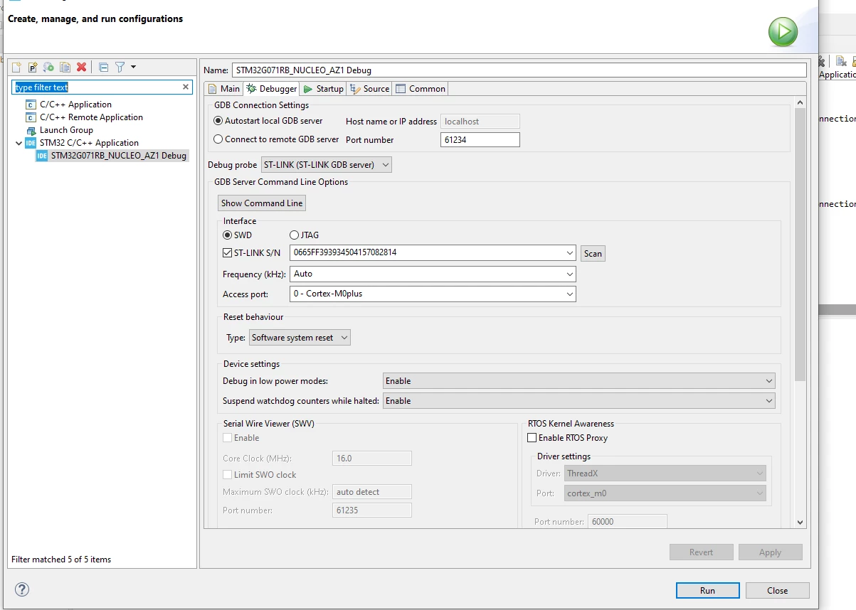

first for the replace, i follow the tutorial but still have the same problem. the version of STM32cubeide is 1.12, i put the file inside this folder
0693W00000aIqijQAC.pngany idea ?
Thanks a lot

Just to make sure did you add the file to the highlighted folder or to the tools\bin\ExternalLoader of it :grinning_face_with_sweat:It is surprising that you have 2 externaltools.cubeprogrammer folder as well. On my side, for STM32CubeIDE_1.12 I only have the second one ( the 0.600.202301161003). maybe try this one ? And then setting the correct external loader in the Debug settings.
