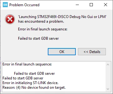

Senior II
May 5, 2022 12:39 PM UTC
I TAKE THAT BACK - IT DID NOT WORK FINE FOR ME!!!
I rebuilt the program OK< but when I loaded into the debugger and ran it, I had some kind of failure (and the operating current was not normal). Now every time I try to run the debugger, I get this:
0693W00000NpLO8QAN.pngI think my development board is fried!
All I did was enable the creation of .c/.h files, and also checked the box to make unused pins analog.
