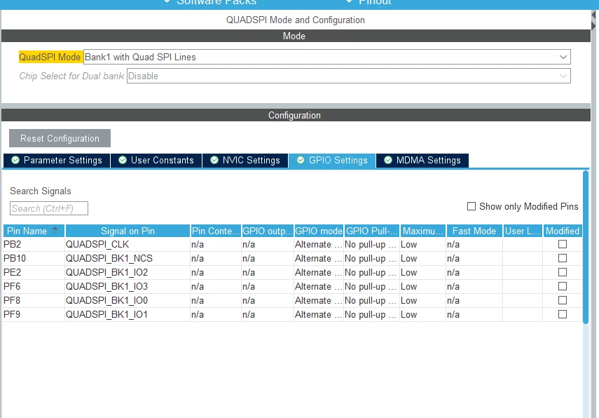

QSPI pinout is as follows:
I've edited the FLASH_Id script - added as a .c file as an attachment.
I would prefer to not use a bootloader, but if that is the only way or quickest way to get this working then please let me know. I have looked at using external loaders but as the pin out of my QSPI is slight different, external loaders will not be compatible.

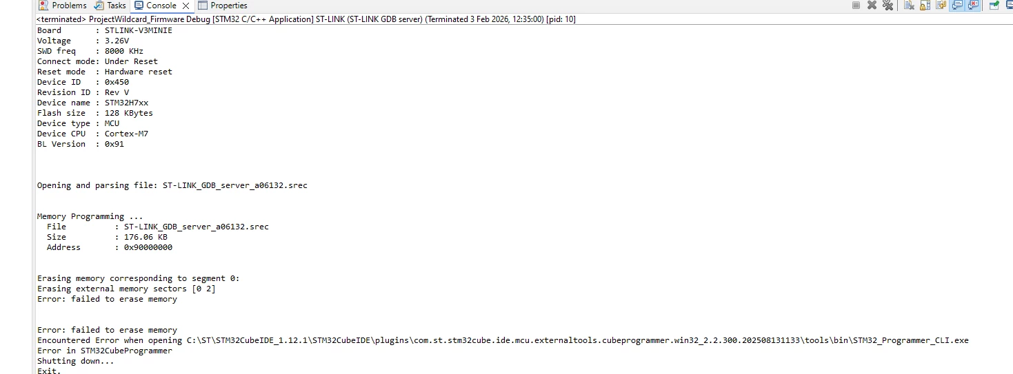

My code compiles but it does not flash:

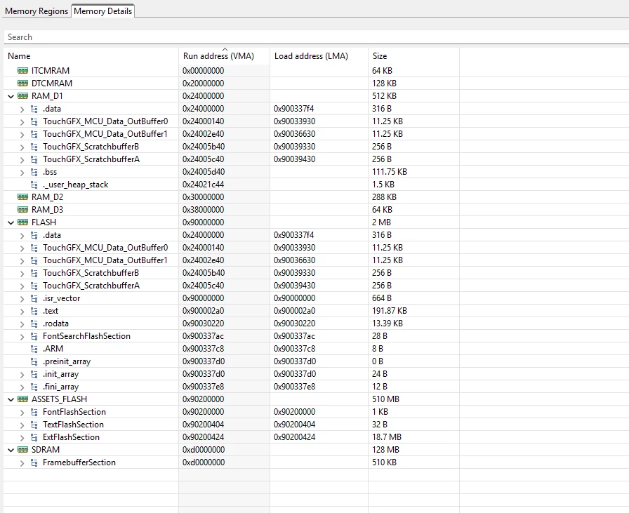

Under 'ASSETS_FLASH', ExtFlashSection does appear as expected after loading images onto TouchGFX.
If you have any suggestions why I can not flash the external QSPI flash IC, please let me know.

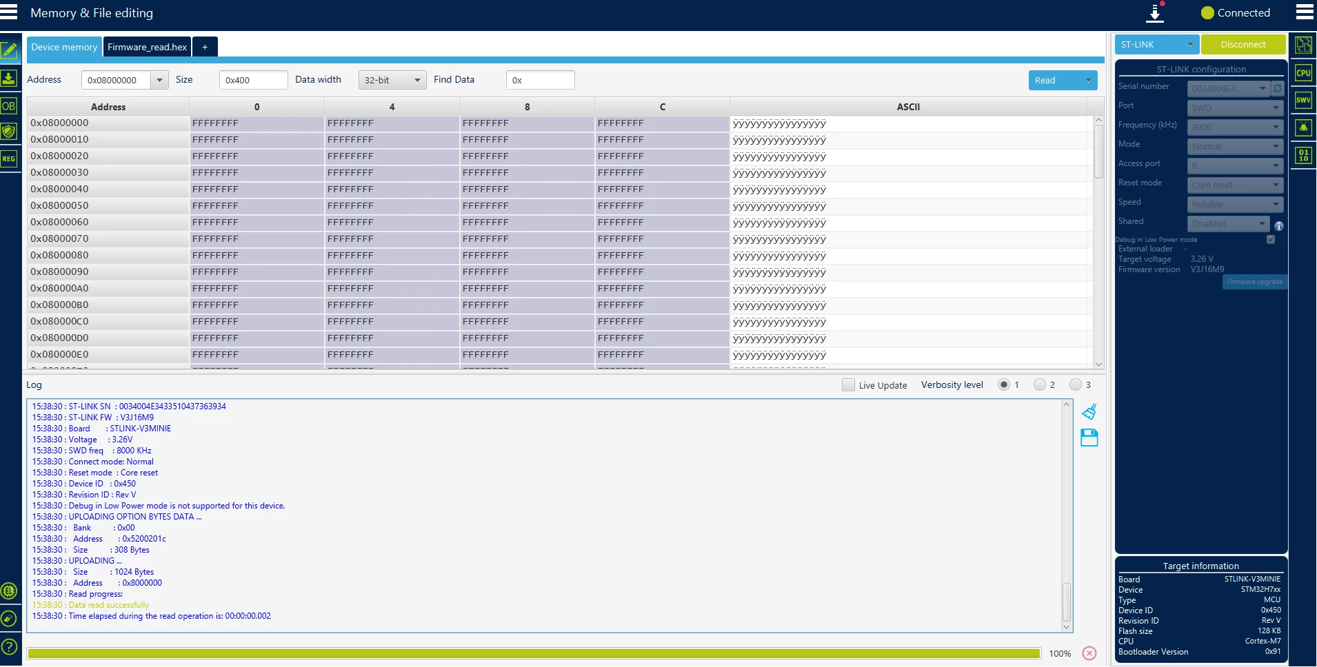

Additionally, within STM32CubeProgrammer I can connect to the MCU. I can successfully mass erase the flash too.
Thank you for any assistance in advance!

Your flash is not 512MB big, it is 512 M bits = 64 MBytes. This is likely the reason why the ext. flash loader failed.
The SDRAM is 128 M bits = 16 M bytes, not 128M.
The execution always starts in the internal flash at 0x08000000, so you can think of the startup code as of bootloader, and it is necessary to activate the external memories before the app can run.
TouchGFX has many examples, please have a look.

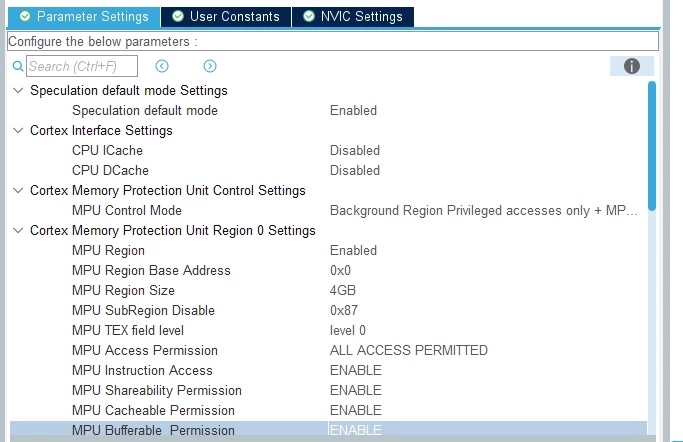

After correcting the flash and SDRAM sizes, it still won't program. Even after changing the MCU permissions for memory protection. So to me that clarifies that an external bootloader is needed?

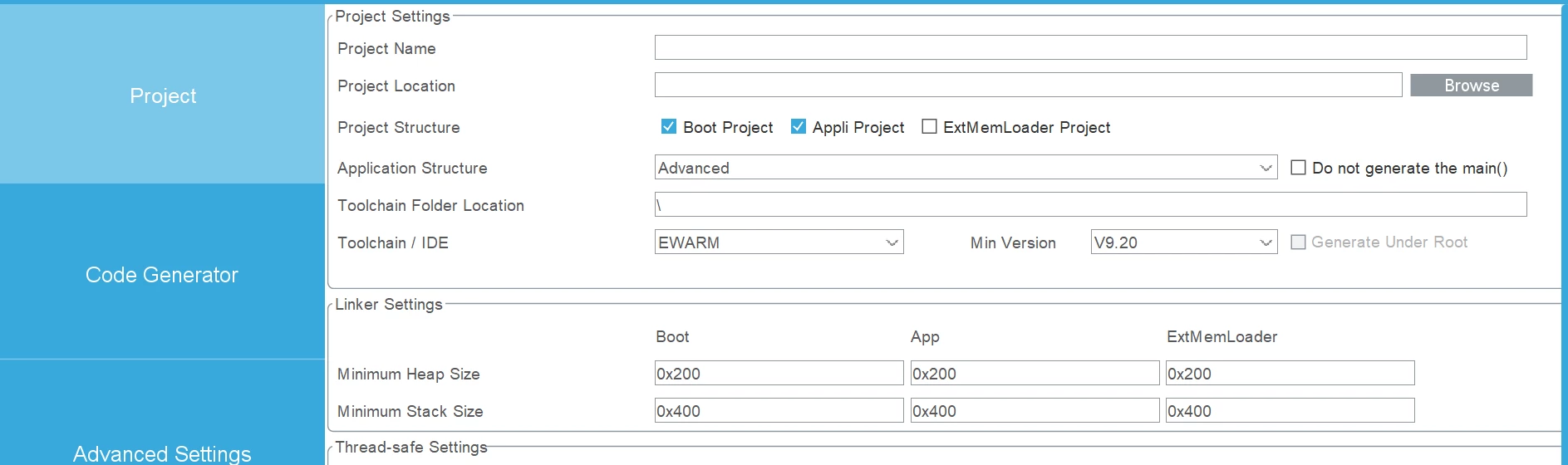

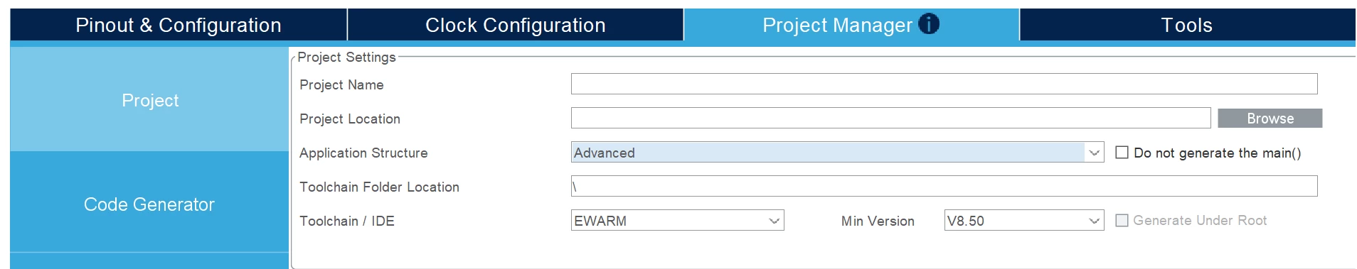

I do not get 'Boot Project', 'Appli Project', and 'ExtMemLoader Project' under project structure when selecting STM32H750IBT6 as my MCU.
This is what I see with a blank project and also with importing the IOC into STM32CubeMX, after selecting STM32H750IBT6.
'Boot Project', 'Appli Project', and 'ExtMemLoader Project' do appear when selecting STM32H7S7L8H6H.
Please advise me further, thank you.
