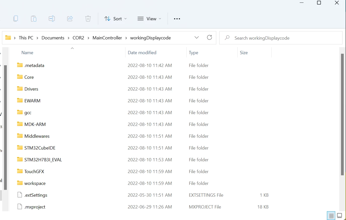

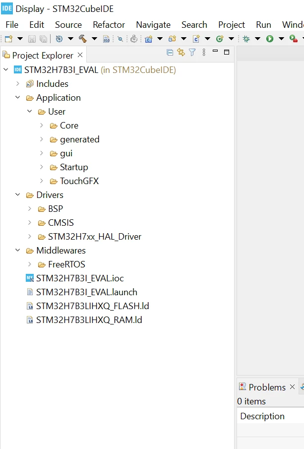

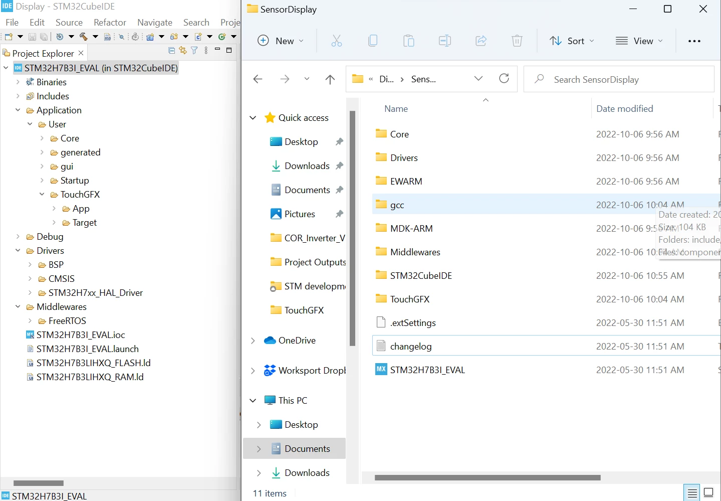

STM32CubeIDE: Different File Structure
I am using the STM32H7B3I-EVAL, which includes a touch screen that uses the TouchGFX application. I am trying to do its tutorials, which includes modifying the code in the STM32CubeIDE. However, when I do, the file structure is different in my computer's file explorer compared to what is shown in the STM32CubeIDE project explorer.
For example, the TouchGFX folder in my File Explorer is not present in the IDE project explorer.
What causes this and what can be done to fix it?

"The level I'm looking at (ADC_Display) does not match what's in the project explorer. "
Again, that's is normal because STM32CubeIDE as a configuration view of it's root folder that is STM32CubeIDE\
"I went into one of the subfolders (ADC_Display/STM32CubeIDE) and I found a matching file directory!"
Yes and that is what I already explain to you yesterday and just above.
"Now, it still poses an issue because this project folder is missing things like the header files and such. Does this information help at all? The .project and .cproject should be in the ADC_Display folder, not ADC_Display/STM32CubeIDE folder, correct?"
No your project generated has no issue. All sources and header file are located on folder above \STM32CubeIDE, like ..\Core or ..\TouchGFX.
Yes these informations are mandatory and STM32CubeIDE is able to found them because the path of the project are correctly configured (see following picture)
These folder path configuration are also into the .cproject file.

The representation of directories in STM32CubeIDE is specific to the way the project was created. This view of your project structure is totally dependent on the Eclipse project in a specific workspace.
You should note that the files in an eclipse project can be physically local to the project, but also linked (belonging to another path)
Maybe this resource could be useful for you:
https://www.eclipse.org/escet/use/projects.html
Also the project you are working on is standard to the STM32CubeMX structure when generating a project.

I find this strange, as I was previously working with this project and the files/folders were visible in the project explorer. I only came back to it recently to try and modify it with my own code. The only thing I changed is that I took it off a company Dropbox and put it in my local folders. Would that change how the project explorer displays the folders at all?
I'm asking because this project was created by the TouchGFX compiler. I tested it with another test project, compiling it the same way in TouchGFX and I can see the file structure there.

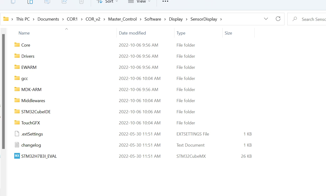

  1. I did import it manually. I copy and pasted the entire folder (including the .metadata) into a new folder.
  2. I looked in the folders and I only see .project. I do not see .cproject anywhere.

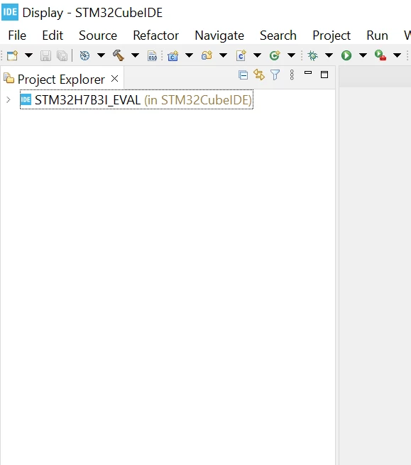

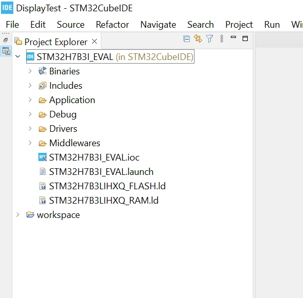

Also, I tried creating a new TouchGFX project and I'm running into a similar problem as before. The project explorer files are incomplete. It is only showing the files in the .ioc executable. Why can I not see Core, Drivers, EWARM, gcc, MDK-ARM, Middlewares, STM32CubeIDE, TouchGFX?
My folder directories are shown in the picture and my workspace is set to Master_Control/Software/Display.

"Also, I tried creating a new TouchGFX project and I'm running into a similar problem as before. The project explorer files are incomplete. It is only showing the files in the .ioc executable. Why can I not see Core, Drivers, EWARM, gcc, MDK-ARM, Middlewares, STM32CubeIDE, TouchGFX?"
In your new TouchGFX screen capture, the project is not incomplete, it is just folding.
In STM32CudeIDE project explorer window, you have to unfold the project to see all the files (the arrow on the left of the project name) Core, Drivers, TouchGFX and friend.....

I am trying to figure out why my folder structure in the CubeIDE's project explorer does not match the folder structure I have in my file explorer. Every tutorial I've seen online for using TouchGFX or any other sample code has the two matching, but mine does not. When I look through the list, I can't find multiple different files too. For example, in that project explorer picture I sent, there are no header files in any of the folders. So clearly something is wrong and I don't understand what.

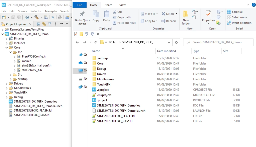

I share with you a CubeIDE project created with TouchGFX where I aligned the IDE (on the left) view and my explorer view (on the right).
For me both structure are identical and all folder, source file and header are present.
And I do not understand why you do not have the same ?
Good luck

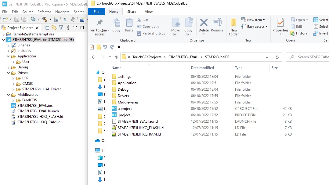

I unfolded the folder in my previous response to do a comparison. I've copy and pasted how mine looks when I create a TouchGFX instance and hit "Generate Code."
This is how it looks, which you can clearly see the differences.
I am confused as to why yours constructs properly and mine does not. Could this be a workspace setting issue? I need to know a solution so I can actually follow tutorials and start learning STM32 programming.
I apologize if this is seeming difficult, but I am at a complete loss.

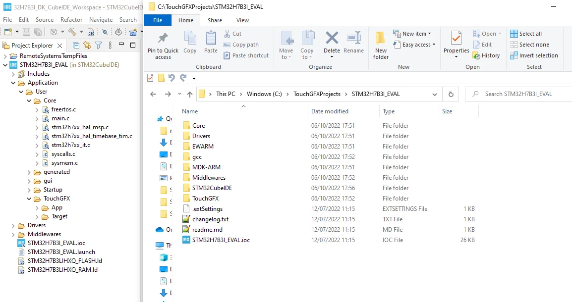

Here my last TouchGFX project generation usin last version 4.20.0 (the previous one was generated with TouchGXF 4.15)
I think the folder structure are different between IDE and file explorer because new version of TouchGFX generate a project that is compatible with 3 different IDE (IAR EWARM or ARM-KEIL and CubeIDE GCC)
This is not an issue, it's just a different view of the projectinside STM32CubeIDE folder.
Do not be confused you don't have to worry about that, it doesn't change anything on your code.
Try to compile it and take a look into STM32CubeIDE folder it match with CubeIDE file structure.

I can compile it without issue. It shows what I intend to show. Yet when I look at the CubeIDE project explorer vs the file explorer, it's still different.

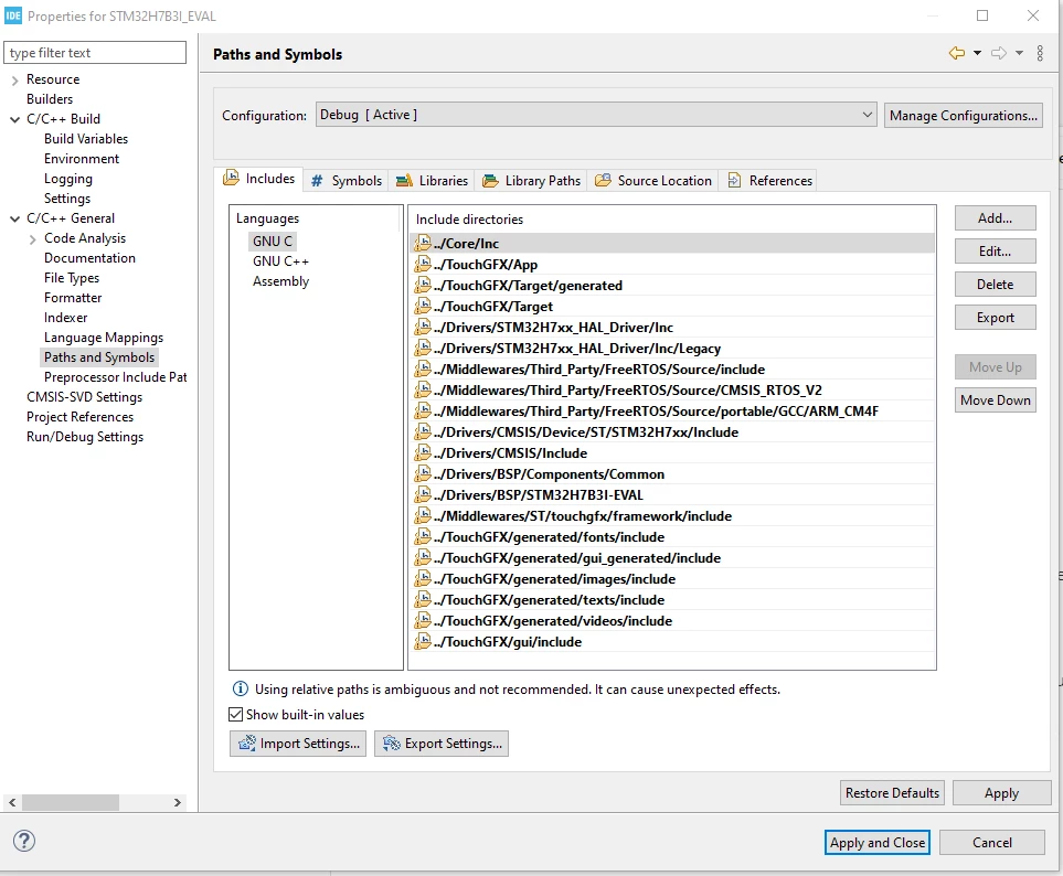

0693W00000UnZNwQAN.pngI confim again there is no issue in your generated project.
