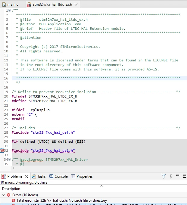

I did deactivate the TouchGFX package from the IOC file and then created a new project using the IOC file but still, I got the same error, although the DSI is not activated on the IOC file still the IDE gives me an error cause it doesn't find the DSI driver header, see the attached screenshot.
0693W00000Kcn7bQAB.pngThank you
JKhal

Seems as bug in MX. For solve copy file to project drivers
from
C:\Users\.......\STM32Cube\Repository\STM32Cube_FW_H7_V1.9.1\Drivers\STM32H7xx_HAL_Driver\Inc\stm32h7xx_hal_dsi.h
and next bug here is you need manualy mark all GPIO LTDC pins with alternate for RGBxxx.
DSI leave Disabled. MX wizard stupidly add only 12 from 28 GPIO LTDC pins.
