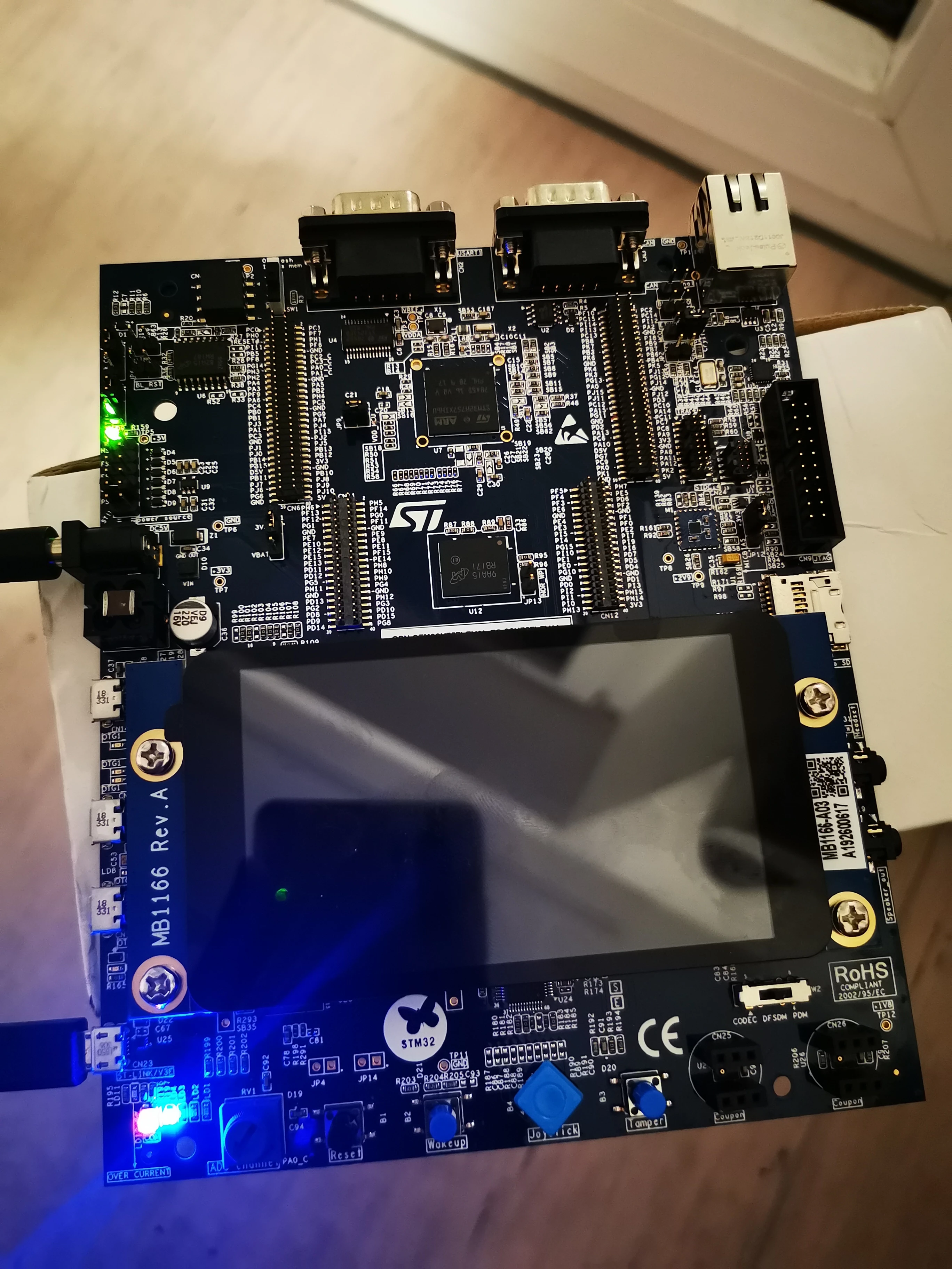

STM32 H757I-Eval Board - LCD not turning on/LED not blinking
EDIT: (normal text: fixed/sorted out(see the new program code in the end) | in bold - still needing help)
Hi, guys! So, I just got this board yesterday and I am having some trouble.
First, the LCD doesn't go on! I plug the power supply, LD9 goes on, plugging the micro A to the computer using the STLINK USB Port, I get red at the LD12 and that's all;
I was following a tutorial on Udemy on how to blink a LED, but although the LED goes on, it doesn't blink;
I even downloaded CubeProg and did those resets to see if 'd help, but it didn't;
Another thing is: How can I completely 'turn off' CM4, so that it doesn't appear on CubeIDE, doesn't generate errors and so on?
I tried to disable it using OB, but still. Every time I create an STM32 Project on the IDE it is there on the project tree, and I'd have to setting everything up for it as well.

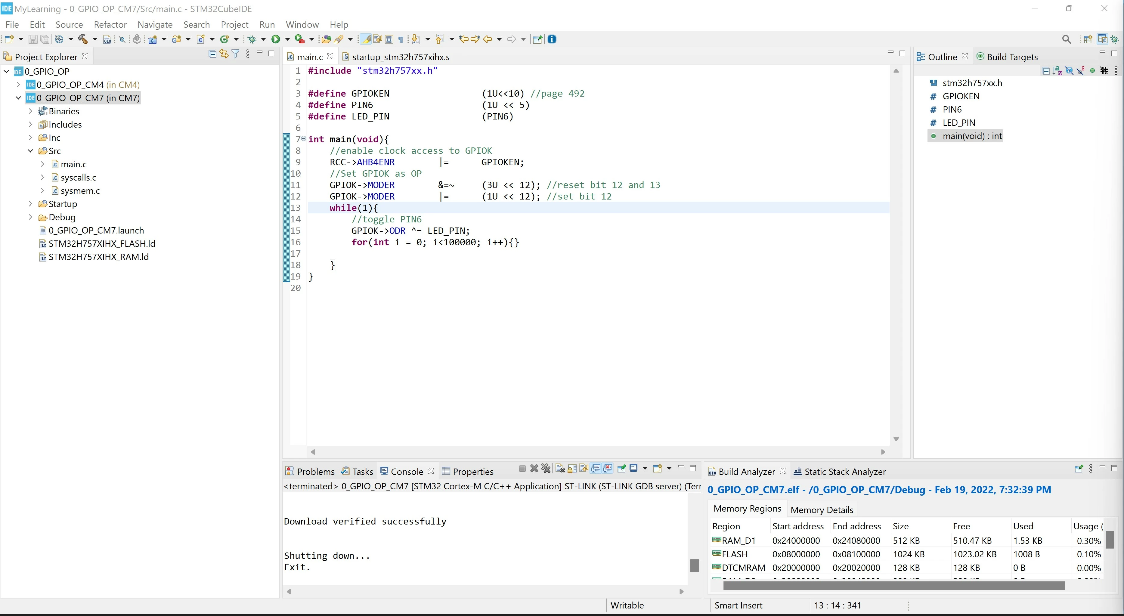

The code I am trying is:
#include "stm32h757xx.h"
#define GPIOKEN					(1U<<10) //page 492
#define PIN6 					(1U << 5)
#define LED_PIN					(PIN6)
int main(void){
	//enable clock access to GPIOK
	RCC->AHB4ENR 		|= 		GPIOKEN;
	//Set GPIOK as OP
	GPIOK->MODER 		&=~		(3U << 12); //reset bit 12 and 13
	GPIOK->MODER 		|=		(1U << 12); //set bit 12
	while(1){
		//toggle PIN6
		GPIOK->ODR ^= LED_PIN;
		for(int i = 0; i<100000; i++){}
PS: I went to the add paths and symbols and added STM32H757xx and CORE_CM7 to the symbols and (using the CubeH7 pack) I added the include folders from Drivers\Include and from Drivers\Device\ST\STM32H7xx\Include;
The code above compiles; I get the blue LED on, but it doesn't blink;
Can you guys help me?
Did I spoil my board by software/hard/core resetting it through the CubeProg?
Why does the LCD doesn't go on? Do I have to change jumpers? Does it need program code first?

The LCD has a complex set of requirements and timings.
On the STM32 you have to set up a frame buffer, the LTDC with its clocks, the DSI to consume the pixel data and funnel it to the display.The display also likely needs a host of its configuration registers set correctly.
It's not that the board is ill-suited to register level programming, but rather that assuming that jumping into the middle of the ocean, clothed, is the best way to learn how to swim, or even a desirable one if you know how to swim.
The CubeH7 should have a handful of examples of driving the display under the Application and Example forks for the board. Use those as a simple starting point, understand how the HAL works, and the overall level of complexity, and then look at how you might approach a register level implementation, if that's even worth the time/effort involved, or if there are more productive and helpful skills you can learn with the board.

If optimize levels is setup in your project your for code is removed out and led toggle on high invisible speed...

February 20, 2022
  • Yeah, the 'ignore the for-loop' point could indeed be a thing, so I tried the code below(see my asnwer to Tesla) and now I can see them blinking; I mean, the for loop seems to be working now;
  • Could you please elaborate on the 'absurd' part? Should I buy another board then, if I wanted to learn 'register coding' or should I keep this one and learn how to work with HAL Libraries instead?
  • They don't really have examples for this specific eval board; they have for the H7457 , though I think some of the H747I code would indeed work with this one;
  • Do you have any idea why the LCD doesn't go on? Is there another specific set of power supply/jumpers, etc... needed in order to use it? I mean, I don't think I am going to program the display yet, since I still have much beginner things to learn, but I wanted to know what that LCD even looks like; without it turning on, I don't even know whether it's functional or not; I didn't want it to have production issues haha;

The bit pattern is for PK5 other PK6​
Konn'
Konn'Author
February 20, 2022
Yeah, during editing the code to paste here/try on the board I forgot to change the LEDs shift;
Believe me or not, I now got them blinking;
MM..1
February 20, 2022
Absurd part is for example LCD with MIPI DSI® interface on your board need around 100 registers config for start working plus next regs for sdram ... You can do this , but your code will be ... but work maybe.
Good point is configure system with HAL and in custom code when required use registers...
