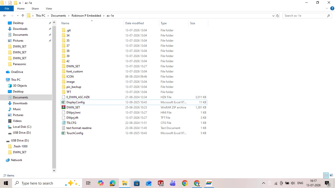

DWIN DGUS: Generated new ICL file and updated DWIN_SET, but display still shows old images and UART communication stopped
I am working with a DWIN DGUS display.
Current Project Structure
My project contains:
Image folders
34
35
37
38
39
42
Each folder contains images starting from:
DWIN_SET folder
22_Config.bin
14ShowFile.bin
13TouchFile.bin
32 (Icon Library)
34 (Icon Library)
35 (Icon Library)
37 (Icon Library)
38 (Icon Library)
39 (Icon Library)
42 (Icon Library)
I also have:
DWprj.hmi
outside the DWIN_SET folder.
What I Did

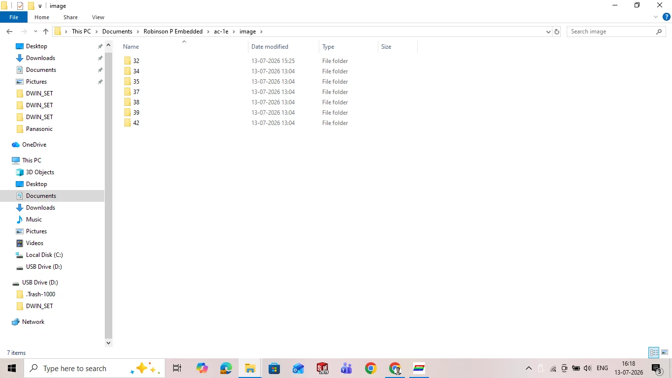

  1. Opened DWprj.hmi in DGUS software.
  2. Opened the Image folder.

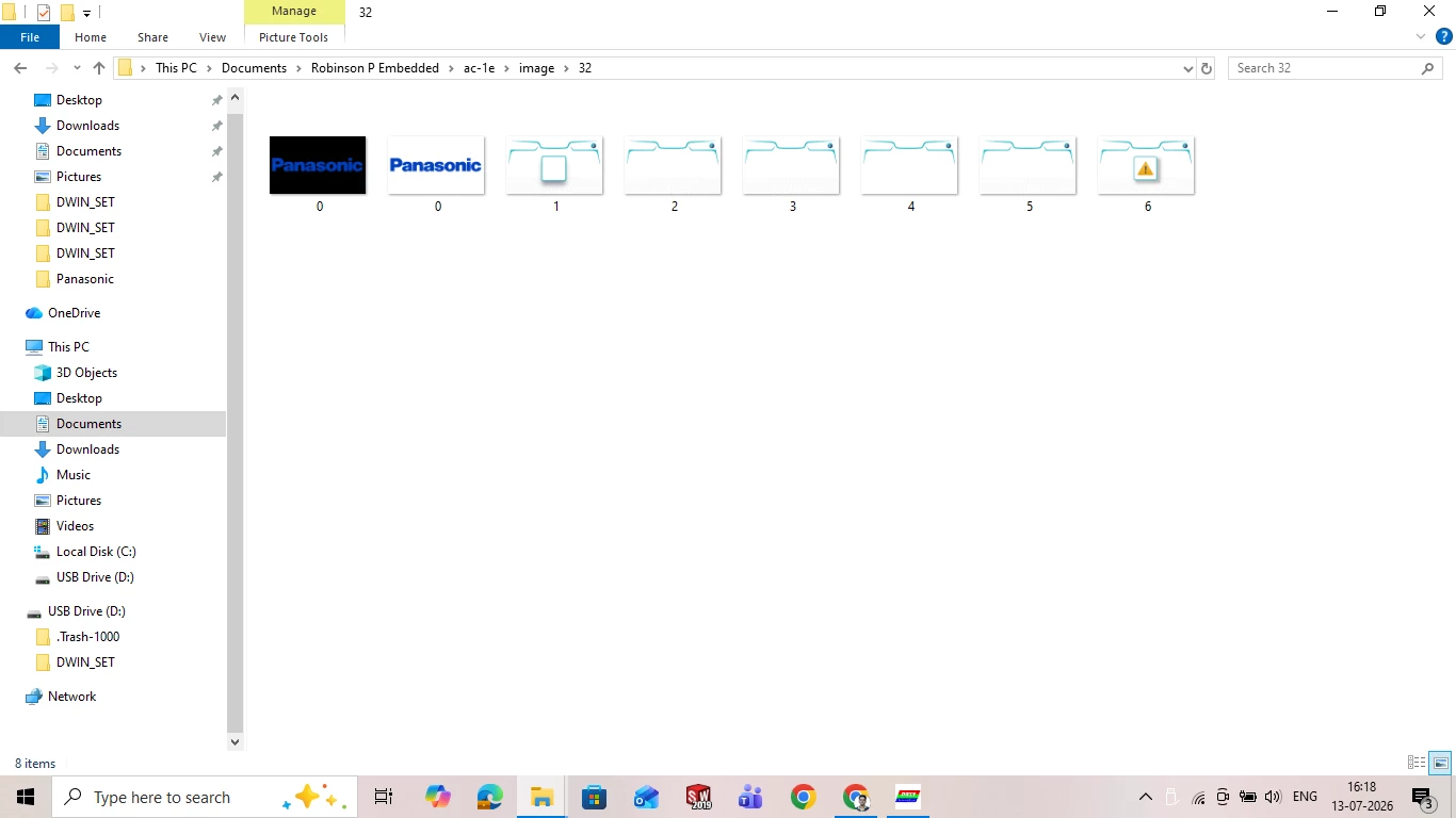

  3. Opened folder 32 in ICL Generator.
  4. Wanted to replace only 0.png with another image.
  5. When I tried replacing a single image directly in ICL Generator, other images seemed to disappear.
  6. Instead, I replaced the actual 0.png file inside the image folder while keeping the same filename and resolution.
  7. Regenerated the ICL file.

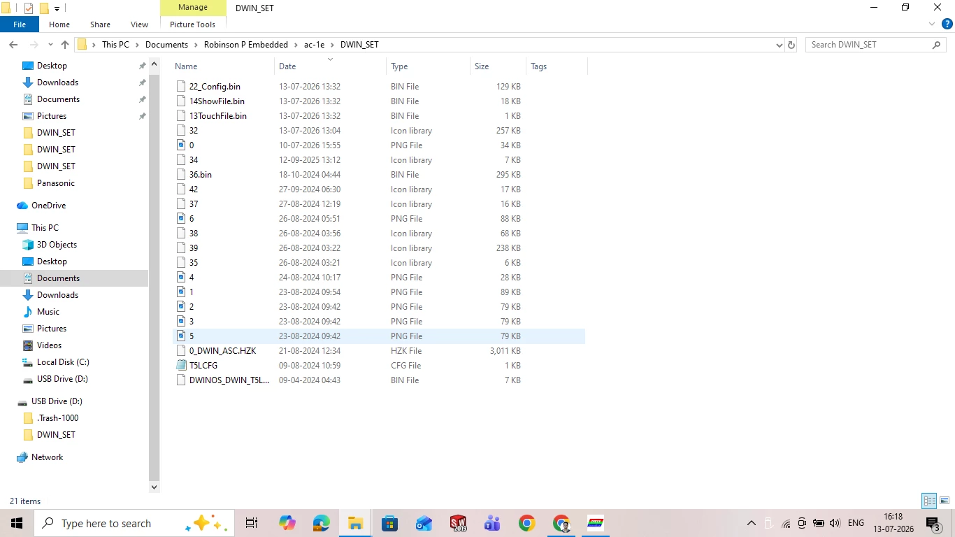

  8. Replaced the existing 32 icon library inside DWIN_SET.
  9. Changed:
    DWINOS_DWIN_T5L_9600__UART5
    to
    DWINOS_DWIN_T5L_9600_UART4
  10. Copied the updated DWIN_SET to an SD card.
  11. Inserted SD card into DWIN display and powered it on.
  12. Display showed the normal update process.
  13. Removed SD card after update.
  14. Powered the display again.
Problem
The display still shows the old images.
My new image does not appear.
Additionally, UART communication with the MCU no longer works after the update.
Questions
  1. Does replacing an image in an icon library require updating only the ICL file, or must I regenerate other files as well?
  2. How can I verify whether the display actually loaded the new ICL file from the SD card?
  3. Can changing the DWINOS file from UART5 to UART4 affect image updates or UART communication?
  4. Is there any cache or internal flash area in DGUS that could cause old images to remain visible?
  5. If only an icon library image was modified, should I regenerate:
    • 22_Config.bin
    • 14ShowFile.bin
    • 13TouchFile.bin
    or is updating the icon library file enough?
Any suggestions for debugging this would be appreciated.
One thing stands out from your description: changing DWINOS_DWIN_T5L_9600_UART5 to DWINOS_DWIN_T5L_9600_UART4 is not a simple image change. That changes the DGUS OS configuration and can absolutely break communication if the hardware or project was originally configured for UART5. Also, if the display update completed but the image didn't change, either:
  • the screen is not actually using icon library 32,
  • the wrong image index is being referenced,
  • the new ICL was not generated correctly,
  • or the SD update did not overwrite the old file.
