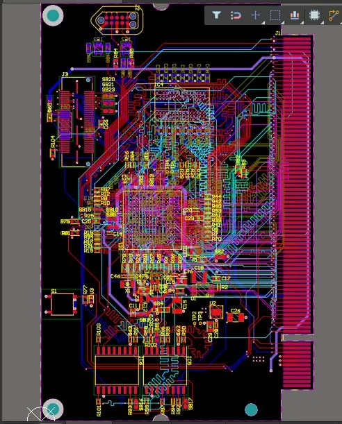

I am developing a board based on STM32H747XIH6 MCU. When TouchGFX support will be added in additional software section of CubeIDE?
