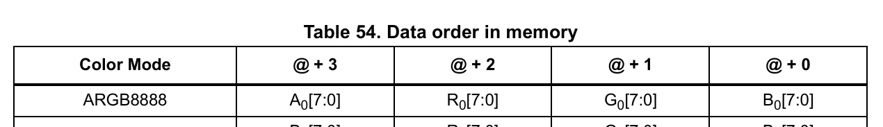

I'm facing a issue with DMA2D to blend some images.
From the naming ARGB means that the order of the colors should be Alpha, Red, Green and Blue.
But if I have a PNG file which contains my image with Alpha, how I have to convert to a static image for my MCU to be able to work correctly  with it with DMA2D?
Normally PNG is using RGBA format in big-endian. But if I'm converting this file to ARGB format and try to blend it over another image, it will work?
Also I'm confused with endianess, because I know that ARM normally is using little-endian.
Which is the best approach to load the image?

The DMA2D order that matters is the order within memory and is given by the reference manual:
If you were to interpret the same memory as a uint32_t, the order would be 0xBBGGRRAA since the STM32 is little-endian as all modern popular computing systems are.
Bit order within a struct is implementation defined. Yes, the bit field you have defined will work in most cases. But it's not guaranteed.

This is an good start for me. I will try to use a union instead of bit fields, something similat to this:
typedef union {
 struct __attribute__((packed)) {
 uint8_t B;
 uint8_t G;
 uint8_t R;
 uint8_t A;
 } components;
 uint32_t value;
} ARGB8888_TypeDef;
I will play a little bit. I will build my own C program on my PC to convert correctly a PNg to ARGB format. Then I will load the static image to MCU, convert to RGB565 and I will try to send it to ST7789 SPI display.
