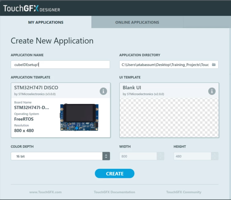

STM CubeIDE support for STM32H747-DISCO based TouchGFX project

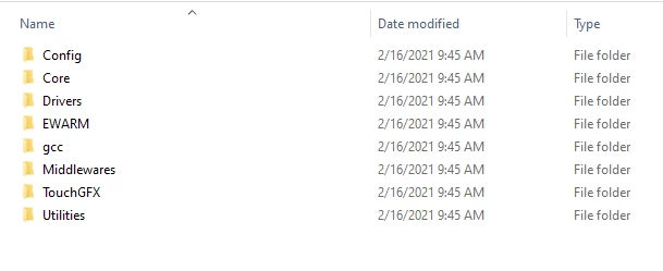

I am working on TouchGFX for STM32H747 Discovery Kit. I have a design created in TouchGFX Designer. I am looking to integrate this into STM Cube IDE. When I hit generate, I am not able to see the STM project being created in the TouchGFX project folder. From some community threads I got to know that application template for H747-DISCO would be ready by the end of 2020. Is it added? Is there another way to do this? Please let me know.
Please refer the screenshots of the application template used and folder structure of TouchGFX project.

TouchGFX 4.17 is now live along a new release of the TouchGFX Board Setup (new name for "Application template") for the STM32H747-disco board based on STM32CubeMX and with a STM32CubeIDE project.
/Romain
