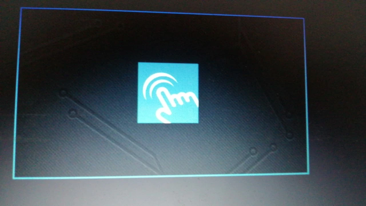

I need to read data from SD card and then send them via uart in STM32f7 discovery kit. so I did the initial setting such as open the text file using fatfs and then inside a while loop I read the data. but I need to execute that when I press fetch button in my UI, but suddenly all fall apart, I don't know exact reason is it because of interrupt of the SDMMC or is there a way to do it safely.

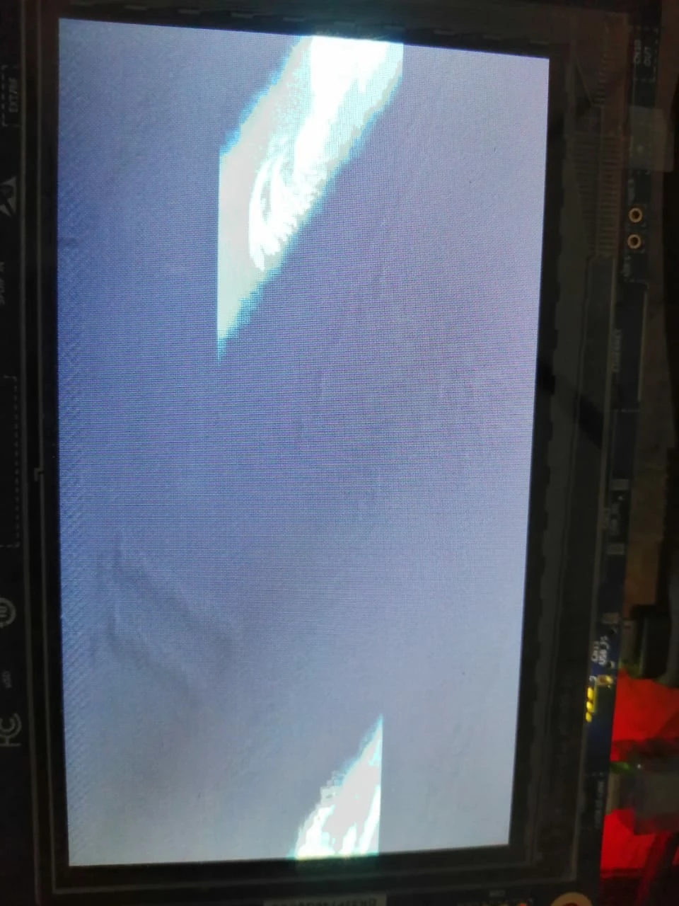

without even coding anything i just setup the SDMMC and FATFS and then with my working code that's for UI, I tried just uploading it. screen goes crazy when doing that, I not even code any thing just updated ioc and regenerated the code
Mar 20, 2024 9:58 PM UTC

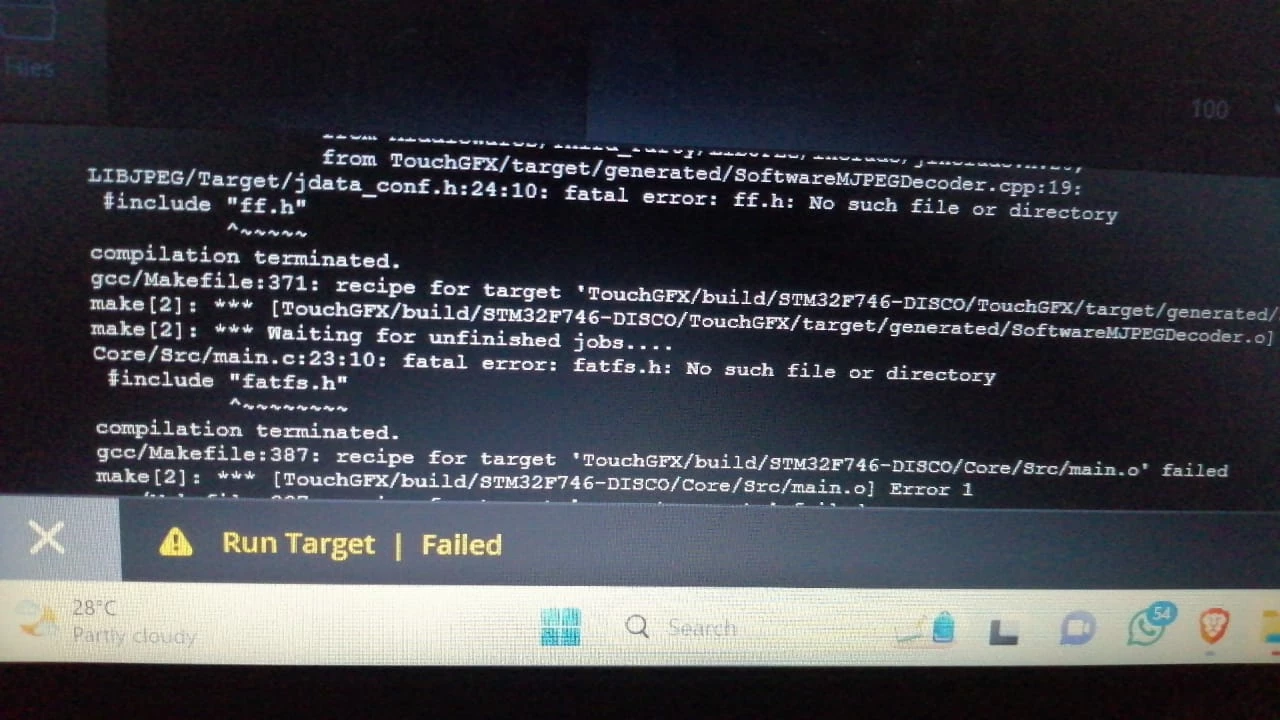

after sd card modeafter sd card modewhat it should bewhat it should becube ide build fine , but in toughgfx its not workingcube ide build fine , but in toughgfx its not working

Hello @sasmithadilshan ,
The makefiles from CubeIDE and Tgfx Designer are different, try to modify <YOUR_PROJECT>/gcc/MakeFile or put your files in  <YOUR_PROJECT>/TouchGFX/target.
Also refer to Using Non-Memory Mapped Flash for Storing Images | TouchGFX Documentation for reading image in a SD card.
Like @SofLit suggested, debugging may help you.
