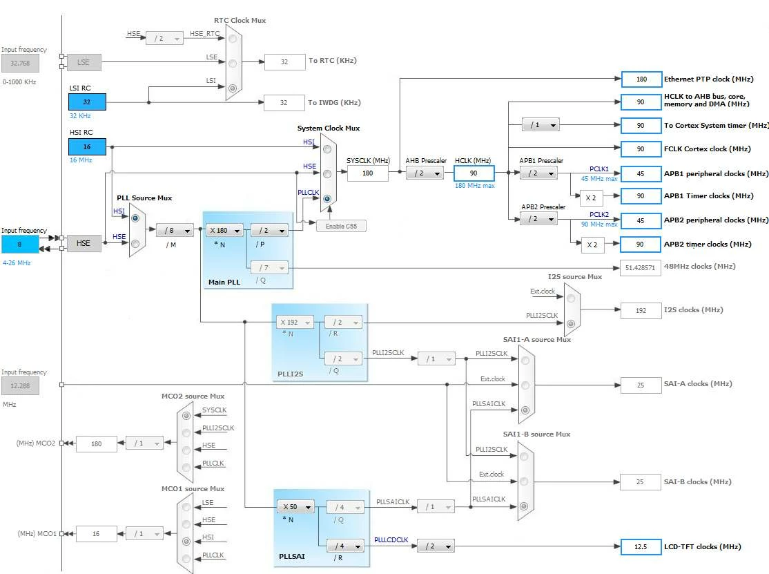

I use a STM32F429 Discovery board with an other Display (Newheaven 800x480,7 inches
http://www.newhavendisplay.com/nhd70800480efatxvctp-p-6912.html

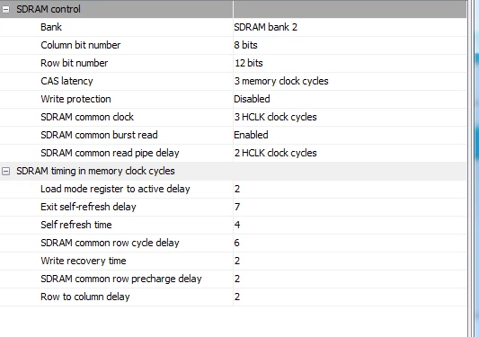

I use the LTDC controller of the STM32F4 to control the display. The buffer for the display is in the SDRAM and I use multibuffering to avoid flickering.
The display is OK, I seen the widget on it but the processor is very slow. Approvimatively 1 seconds to refresh a picture and copy the content from one buffer to the other.
I suppose it's come from the access conflict to the SDRAM but I don't how to configure it.
Here is my clock configuration:
My FMC config is here:
Do you knoe how to configure it?
Thank in advance.

Posted on June 21, 2016 at 21:31
Thank you Hannibal,
My SDRAM seems to be correctly connected.
I have mesured with an oscilloscope and the GUI_MULTIBUF_BeginEx takes 400mS to execute (Display 480x800 in 16 bits for the 3 colors and processor at 180MHz).
Don't know why.
Best regards and thanks
