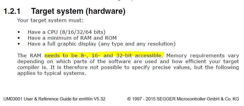

Vangelis Fortounas
Aug 28, 2017 12:04 PM UTC
Posted on August 28, 2017 at 14:04
Hello !
I am using 8MB sdram with 32bit interface.
This means that if you try to access an address like 0xC0000002 you will get wrong results.
Any read or write to this memory is virtualy ANDed with 0xFFFFFFFC. The two LSbs are allways masked from FMC controller.
The internal MCU RAM conforms to this requirement  but your SDRAM not.
So you need to change  your memory configuration somehow to conform the STEMWin requirement.
