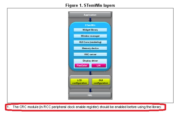

I have Downloaded STemWin from the STM Website and i have tried to build a simple ''Hello World'' Application on my STM32F207 with KEIL 4.72a, but my Application goes into an infinite Loop in GUI_INIT().
I have found a hint onn the Segger Website, that GUI_Init() tries to acces the provided memory area with 8, 16 and 32 Bit accesses. This memory Area will be assigned by a call to GUI_X_Config() (provided by my code), but GUI_X_Config will never be called by GUI_Init().
I used the Library files STemWin520d_CM3_Keil.lib (without OS) and STemWin520d_CM3_OS_Keil.lib (with OS support). What can i do to find the problem?

Add
  /* Enable CRC clock */
  RCC_AHB1PeriphClockCmd(RCC_AHB1Periph_CRC, ENABLE);
Prior to calling the function.

Hi Clive,
Thank you. This is correct and mentioned in our documentation to call that function prior to use GUI routines.  I thought that the default examples are used, which is active by default.

Yes, that's it.
And yes, after searching for ''CRC'' in the documentation, i found a footnote(!) on page 6 of AN4323 about it.
Thank you again clive1.

I'm working blind with the register data you provided, the library is locked to STM32 hardware with this, presumably the F2 and F4, I didn't check the location on the F1
I think the documentation would have been a lot stronger if the main() example explicitly included this code. That note on the diagram is totally lost.
