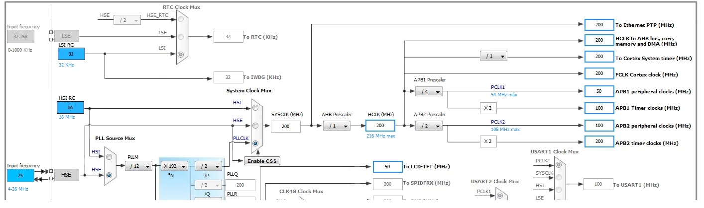

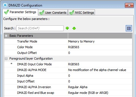

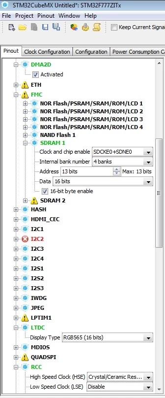

Some configuration screens from STM32CUBEMX.
Pinout:
DMA2D:

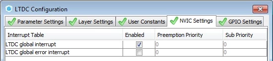

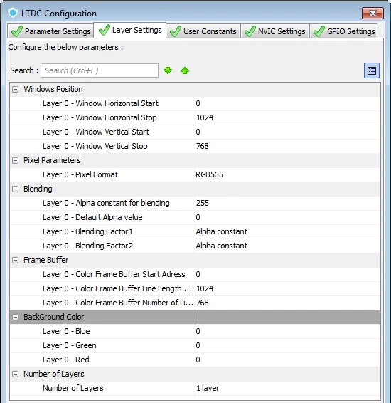

LTDC:
0690X00000604b0QAA.jpg0690X00000604kqQAA.jpgColor frame buffer start address for Layer 0 reassigned to 0xC0400000 in LDC_X_Config()

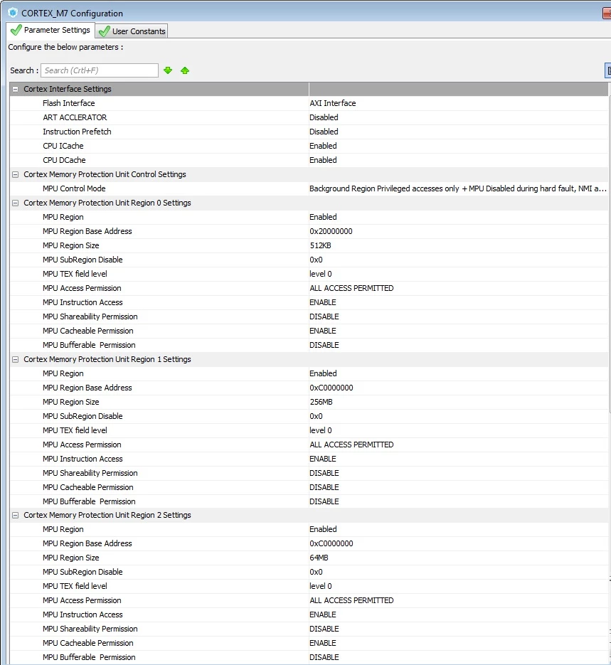

MPU:

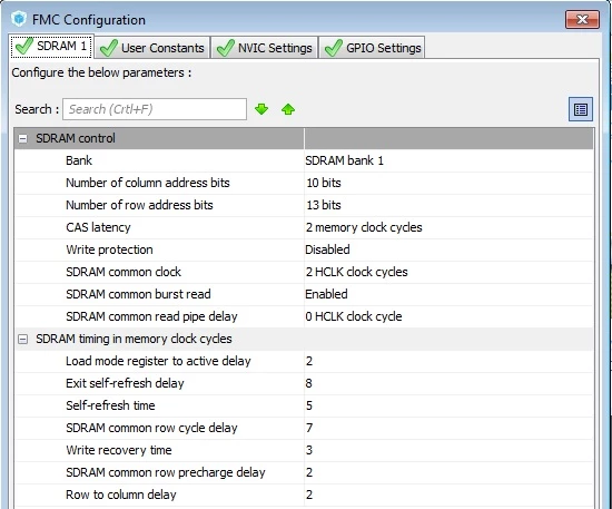

0690X00000604JSQAY.jpgSDRAM:
(See attached image SDRAM)

It seems that problem is in MPU regions configuration as I'm using STM32F777ZI chip.
AN4861 contains recommendations how to configure the MPU regions in case of graphical memory allocation in SDRAM.
AN4838, AN4839 contains recommendations how to configure the MPU regions as such.
Cortex-M7 has a complex system to handle access to the memory regions. And I'm currently having a hard time configurating the MPU regions for SDRAM space.
