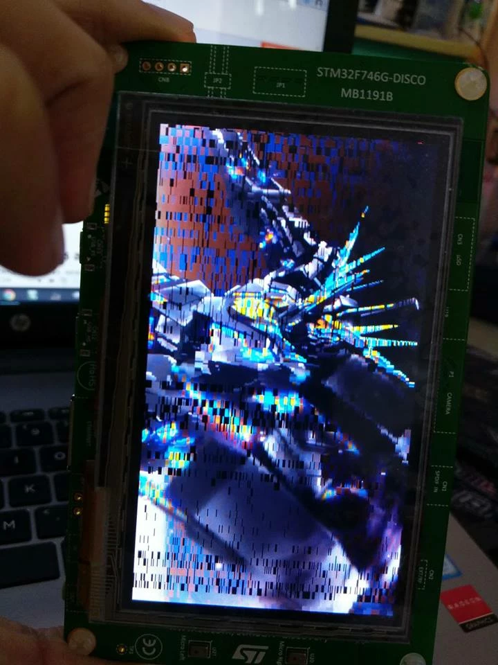

While the display on the LCD is: 0690X00000604HtQAI.jpg
I used the Memory device to store the code like this:
/* My code begins */
GUI_MEMDEV_Handle GUImem;
BSP_SDRAM_Init(); /* Initializes the SDRAM device */
__HAL_RCC_CRC_CLK_ENABLE();
GUI_Init();
GUI_Clear();
GUI_SelectLayer(1);
GUImem = GUI_MEMDEV_Create(0, 0, 480, 272);
GUI_MEMDEV_Select(GUImem);
GUI_JPEG_Draw(_acgundam1, sizeof(_acgundam1), 0, 0);
GUI_DrawLine(0, 0, 99, 99);
GUI_MEMDEV_Select(0);
GUI_SelectLayer(0);
GUI_MEMDEV_CopyToLCD(GUImem);
/* My code ends */
Can anyone gives me a hint or a way to fix this error? Or may be some references is fine too. Thank you very much!

did you check the polarity and phase of your clock signal ?

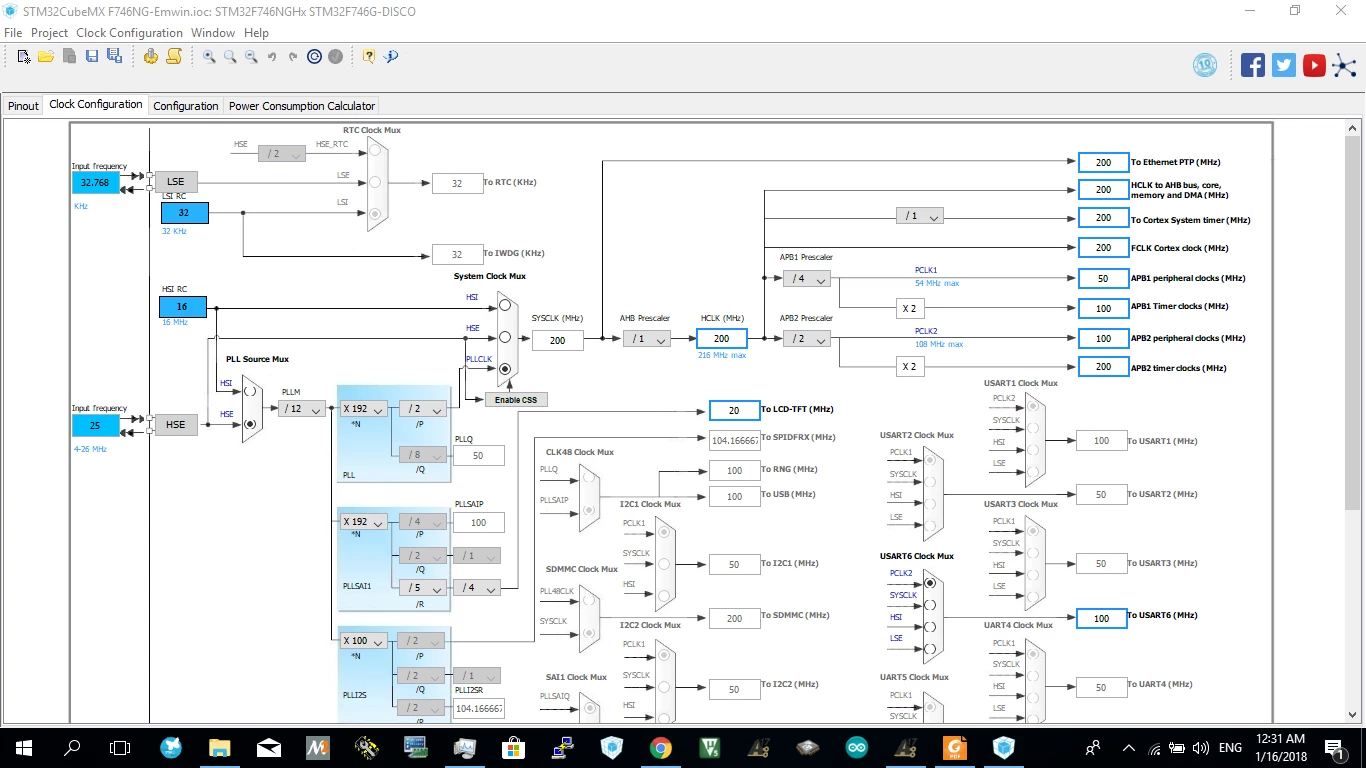

Hi TJ,
Yes I did, this is my clock config with the CubeMX

are you using 5-6-5 format ?
did you check the dot rate ?
20MHz to the LCD seems low.
Maybe someone from the ST team will know about an example to use the STemWin 5.40 in the STM32F7Cube 1.8 pack with the F746-DISCO

there are several physical requirements for an LCD.
the Dot rate must be closeish and the phase and polarity correct.
the data length 16bit/18bit/24bit must be set correctly for the connections you have, that set the colour format.
Thats usually 16 bit 5:6:5 = R:G:B

Thanks TJ,
I guess I should check the datasheet of the F746-DISCO since I don't know much about the its LCD. Hope it would work.
