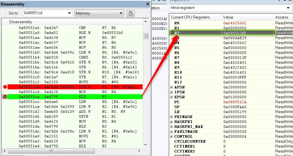

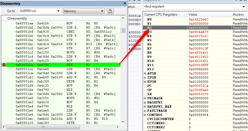

3 - When make a program with TTF font create and initialize GUI to external memory it run with hang hard fault error invalid instruction.
4 - But when put a break point above that hang point and run it again. The data read from external RAM had value available.
Please help me if any one has idea how to debug this problem ?
