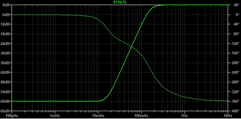

I'm working on an GUI that has mainly a static graph wich plots bode diagrams. So i have been searching on the API of touch gfx ways to make a logspace in x-axis in order to plot frequency but a i didnt find a way to change the linear magnitude of x-axis.I would need something like this:
Is it possible to manipulate x-axis scale?

Manipulate the x-axis scale is possible in TouchGFX. The function used are :
 // Adjust the X-axis max value
graph.setGraphRangeX();
//Adjust the interval of the labels/grid lines on the X-axis
graphMajorXAxisLabel.setInterval();
graphMajorXAxisGrid.setInterval();
However, the logarithmic based axis is not (yet) natively supported on TouchGFX. This is maybe something we can do in future, I'll suggest it to my colleagues.

Okay, yes implement that would be great because my project is based on bode diagrams, so is one of the pillars a xlog space. Anyway, maybe I could manipulate those axis in lower level functions?

JPine.1Author
November 6, 2022

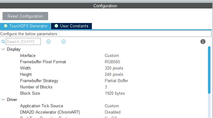

Hello Again, i managed to make a log scale graph adding lines. It works fine. However, i have done a logic to switch between two graphs that already have their points loaded on the widget, and the refresh of the screen is very slow, it takes about 3 seconds to set one graph visible and the other not visible. It's a problem of the widget or my MCU?. I'm using NUCLEO f401RE with 84MHz of clock and 30uS of refresh of the engine. Also im using the partial frame buffer strategy. Here is the logic code for switching graphs:

And the config of TouchGFX:
Romain DIELEMAN
November 7, 2022
I suppose your graphs take almost the full screen ? If yes then I am not surprised that it would take some time to disappear and be replaced by another. With the partial framebuffer strategy you only update blocks of the screens at a time, so full screen animations can take some time and also show some tearing effects. To speed up your process you can either change the framebuffer strategy or try to play around what you refresh on your display. You need to reduce the size and the amount of things you update at the same time. In the simulator I recommend to use the different features available, like "F2" to show what zones are updated, "F9" to pause the simulator and "F10" to go one tick at the time so that you can see exactly what zones of the display are being refreshed when you go from a graph to another.
