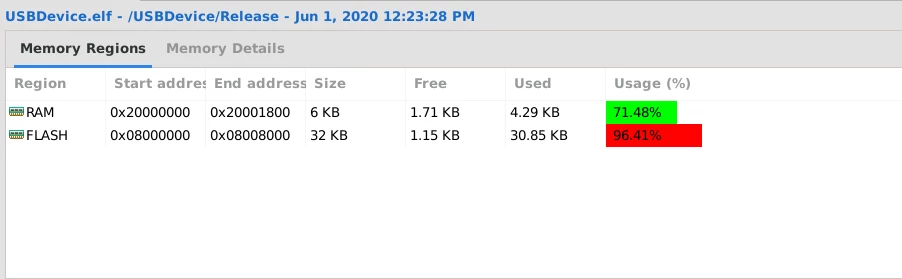

0693W000001pmojQAA.pngGuess this calls for the bigger STM32F070RB device (o;
Deleted some unneeded graphic functions and fonts...but when adding the PID controller:
